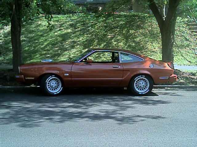

I have these for my Cleveland. Been about 10 years on now. I had great luck and wouldnt do anything else unless it would fit better. The only problem is the botom tubes tend to dent when ya hit stuff on the highway at speed. I have stiff springs though so I dont really bottom out much. My car is lowered a bit too for a better look with the larger tires. The collector flange is about 3 inches from the rear lip of front wheelwell and the flat collector was dented in a little so it would fit up nice and tight. With these pipes I have 3.5 inches of clearance measured under the crossmember.
