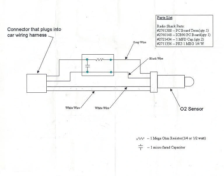

WHat you need are called MIL eliminators. However they are no longer made due to the gov't making them illegal. You might be able to find a set used or make your own
