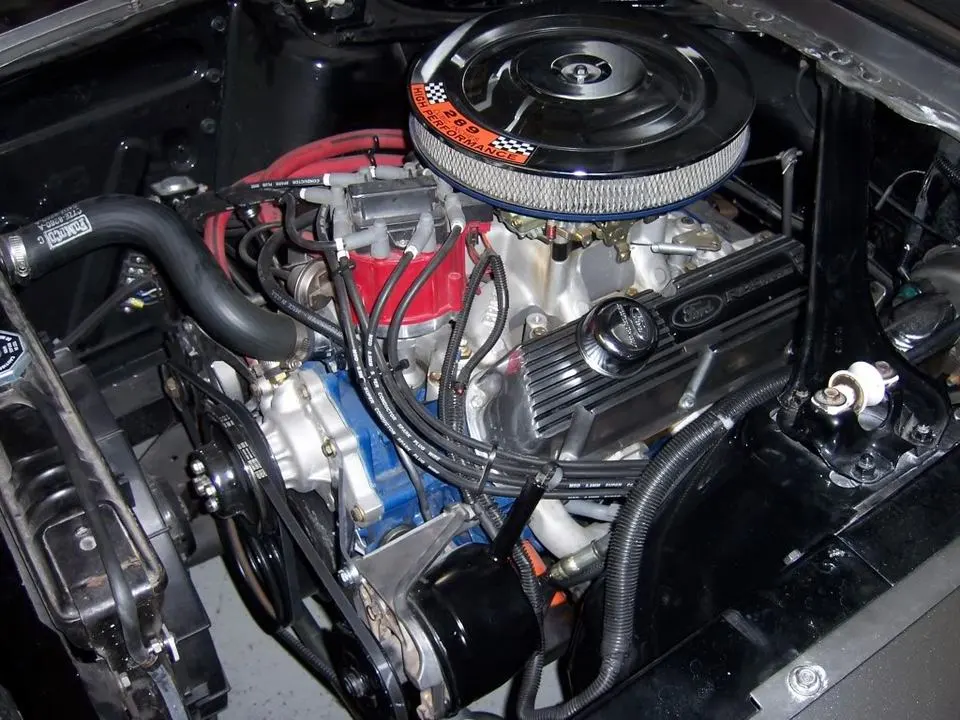

Here is a pic of my HEI. I needed to use a 1" carb spacer to get my aircleaner to fit over it.

My HEI clears the AC bracket and compressor on my 68 with a 289.

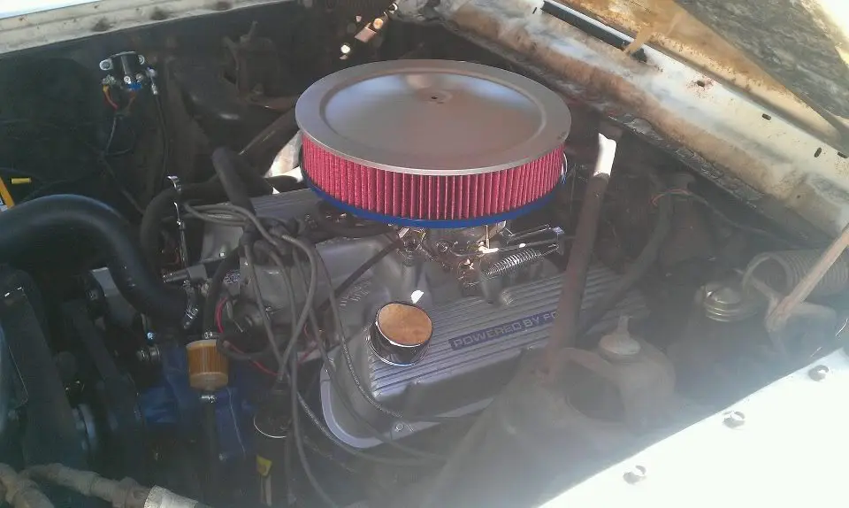

I used Pertronix in the 302 in my Fairlane, and IMO, my distributor looks more like it belongs there, more like a Ford.
