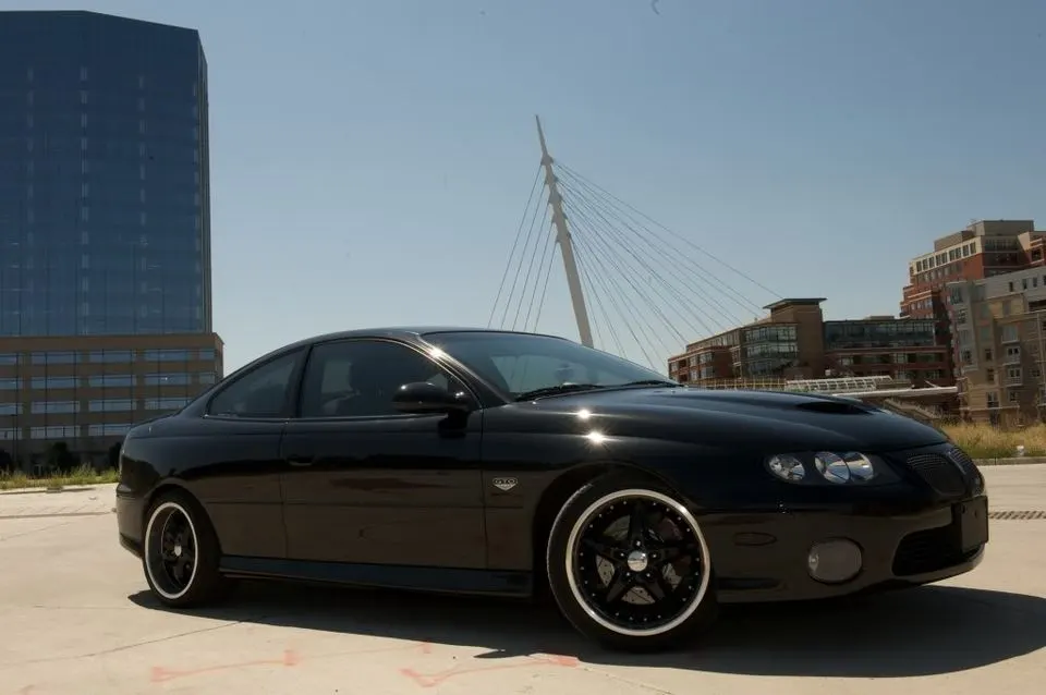

Hey guys I know, I know .. I gm guy on a ford board.. but I come in peace lol.
I'm sean and I drive an 05 GTO with a built/forged 402 stroker. she is somewhere around 480rwhp plus off the bottle.. I plan to spray in the future.
here is my car...

Nice GTO - black is beautiful and you've done a fine job with the mods.

those tires look skinny on that GTO, must be the picture.

that's a really good looking gto!

Nice GTO!
