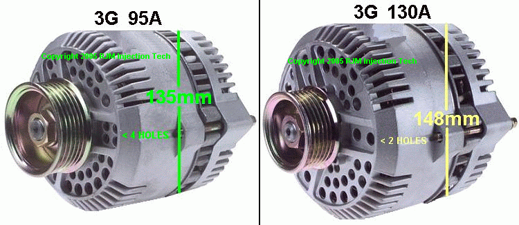

Make sure it's actually a 130A 3G and not the more popular 95A version. I've see 95A versions advertised as the 130A version on Ebay regularily. There are small differences in the case that if someone didn't know any better, woldn't pick up at first glance.
Crap i just saw your post getting back from New Hampshire today. I can't really tell from the pic aside from the fact that it looks like it has the smaller pulley on the one i bought. It was only $30 so if anything i'll shelf it when i buy the one i want as a backup. It came from a 93 Bronco and i know those came with the 95A. But maybe this one was upgraded? (Cross Fingers)

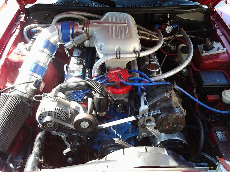

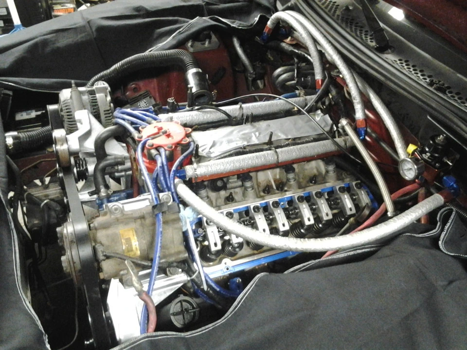

OK so here's how i ended up with the truck brackets. Figured i would give an Update. Looks nice and makes things east to work on. I can use the OEM A/C (Which i need to somehow fabricate custom lines) But i also get the 3 Bolt Alternator. The cheap on off ebay wasn't the 130amp i was hoping for. But it got the car out the door. The car will be getting parked soon for the year anyways.
