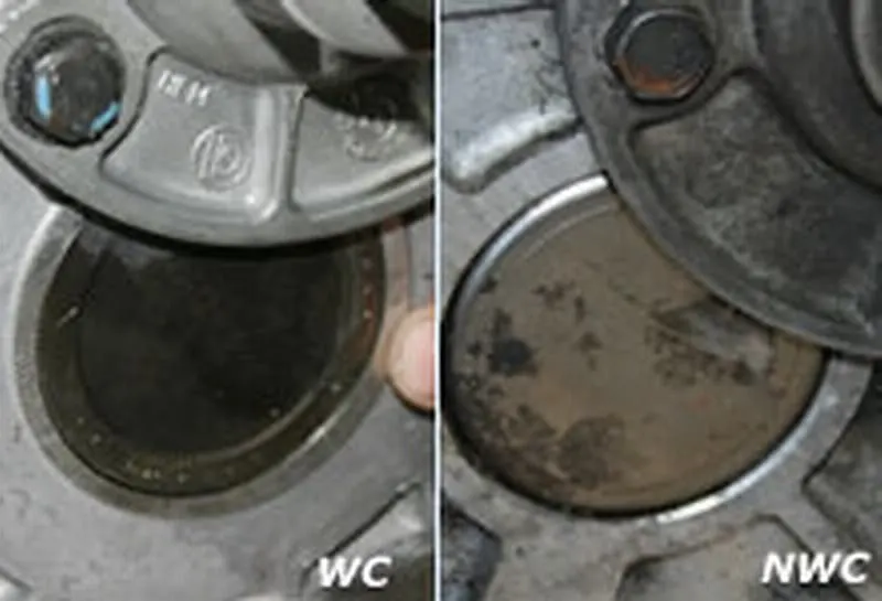

If had a picture it would be easy to identify, but something tells me that if someone actually went to the trouble of purchasing one brand new and installing a shifter on it, it's probably a World Class unit.

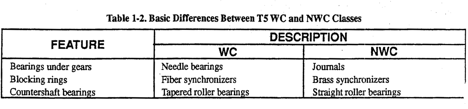

Depending on the year of the transmission & tag Id, the torque ratings are the same. The WC probably shifts somewhat better,
See http://www.ttcautomotive.com/English/products/tremec.asp for more information - check out the "Light Duty" group, since TTC makes monster transmissions for big trucks as well as passenger cars.
T5 identifier information.
On the tail shaft of the transmission, there will be a stamped aluminum tag. The tag will have a number on it that you can cross reference to the chart below. There is no other way to find out what type of T5 it is without disassembling it. All the rest of the numbers on the outside of the T5 case are part numbers which are not unique to any particular T5 model.
Remember that 94 - 97 T5's have a longer input shaft (about 11/16” longer) and can only be used with a 94-95 bell housing unless you modify or replace the input shaft.
T5's used with a 4 cylinder have a 3.93 first gear, reduced torque ratings and an input shaft pilot diameter that is smaller that the T5 used for V6 & V8 engines. The pilot diameter is .59" compared to the .668" used on V6 & V8 T5's. It requires a different pilot bearing to be used with a V6 or V8. The pilot bearing you need is for a Ford Ranger diesel from AutoZone part #14672
t5-identifier-gif.68815
