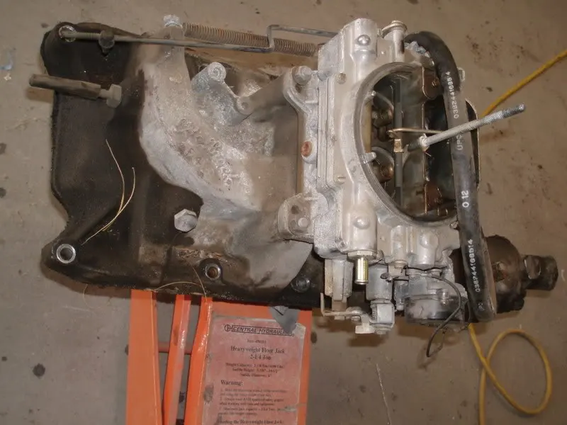

http://i74.photobucket.com/albums/i264/clspade/P5150325.jpg
that one is just hte motor it looks like it has a lot of build up to me...but ive never taken one down before

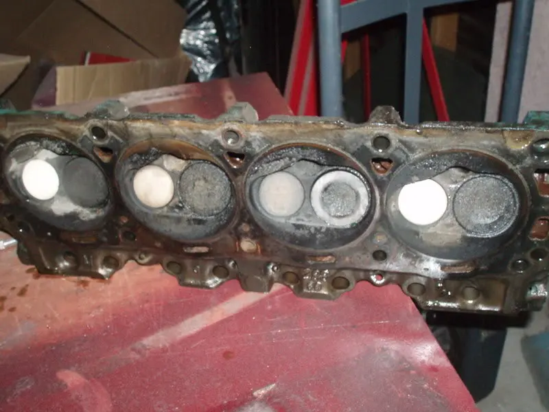

http://i74.photobucket.com/albums/i264/clspade/P5150327.jpg
that one is an overview of the head

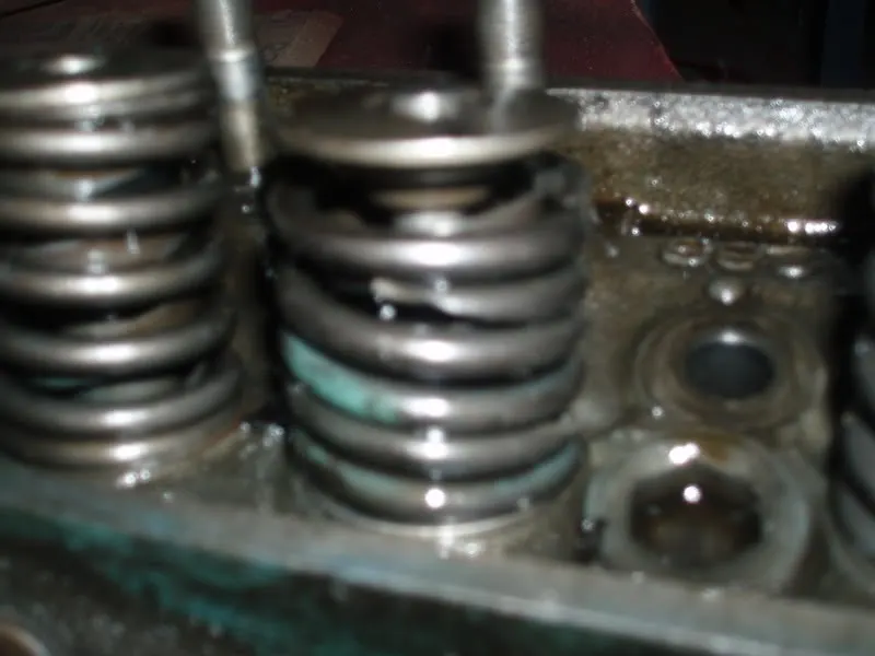

http://i74.photobucket.com/albums/i264/clspade/P5150331.jpg
the culprit..little blurry because i took off the flash but you can see the gap and thats even if i pull it back

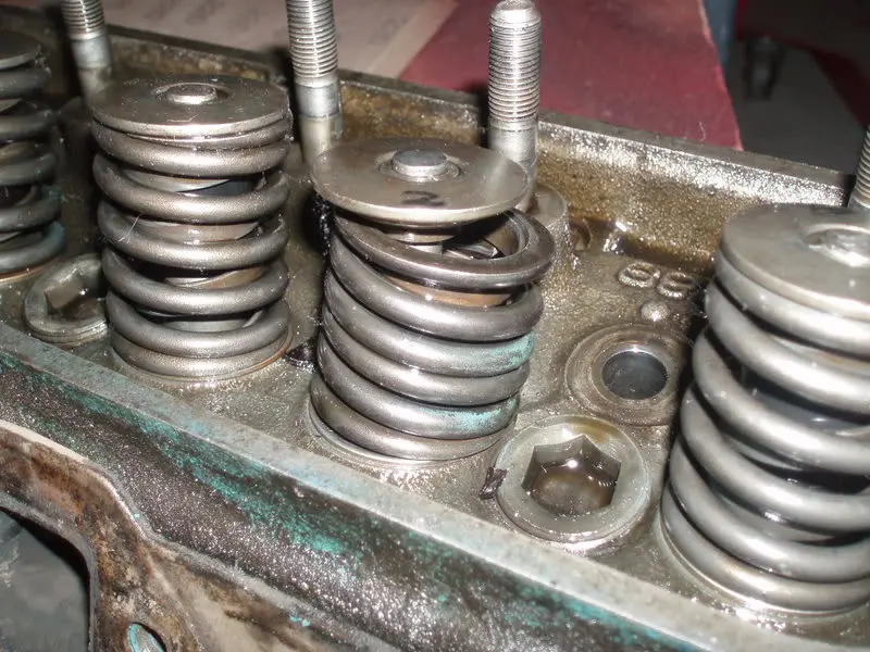

http://i74.photobucket.com/albums/i264/clspade/P5150332.jpg
just a picture of the spring
http://i74.photobucket.com/albums/i264/clspade/P5150333.jpg
another of the spring

The dampiner, is basically it is the spring within the outer spring. If look closely at your spring you will see another spring inside the outer spring. The dampener is supposed to eliminate/reduce the spring harmonics at high RPM...

It looks like your valve spring snapped in two, and the top half curled down around the lowe half. This happened to my 289 a couple years ago. The valve went through the piston and the rod went through the cylinder wall. I still have a small chunk of piston with pieces of wrist pin, rod and valve protruding from it. I think you're lucky the valve didn't drop any lower than it did. If you can afford it I would replace all the valve springs. But, you can probably get away with just replacing the one spring.
