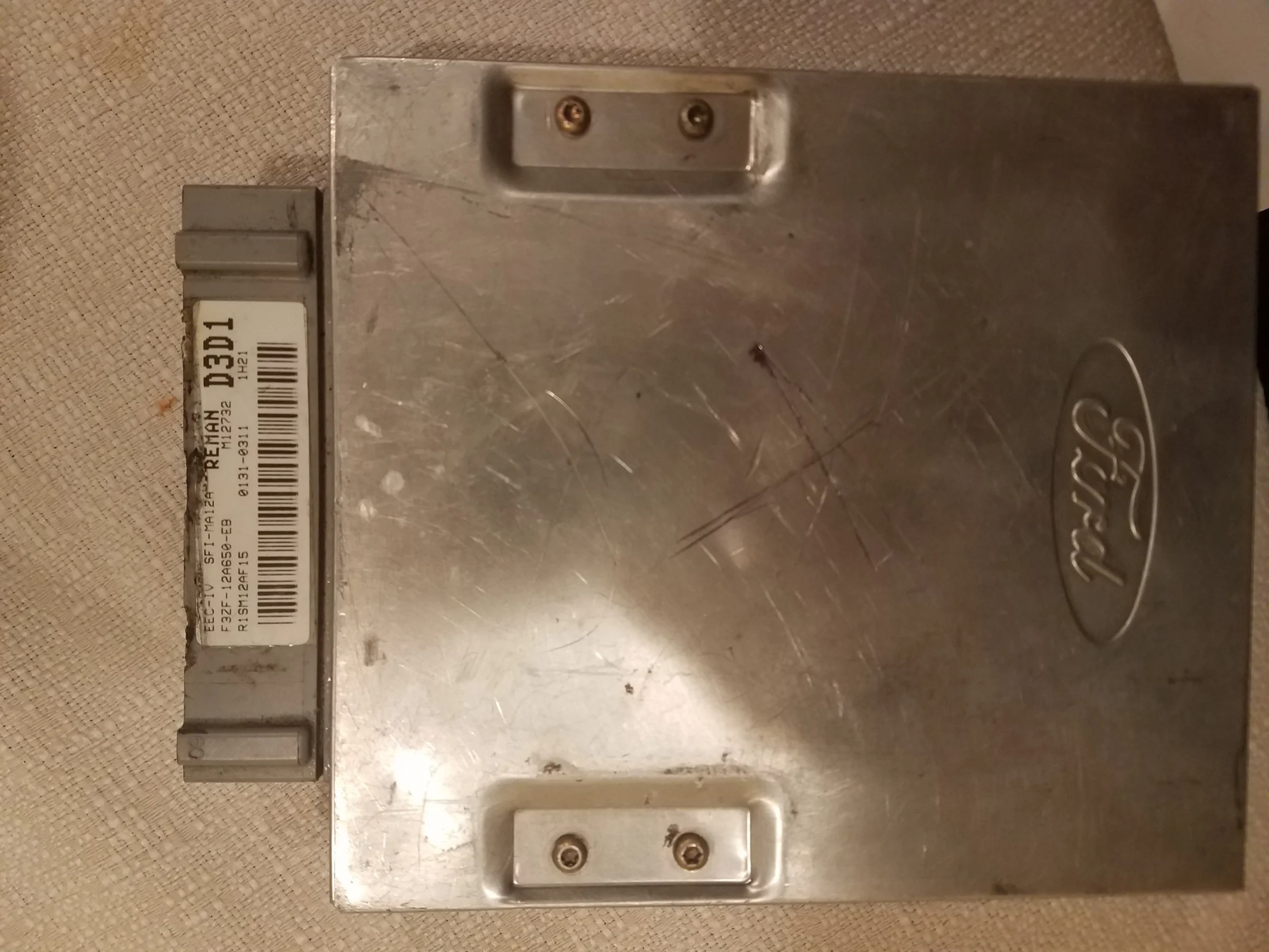

I look at the ground to see if it's messed up and I have a question of a ECU laying around can I use this on my car I just wanted to see if it's the computer or not the number is different it's has D3D1 the one on my computer says a A9S
