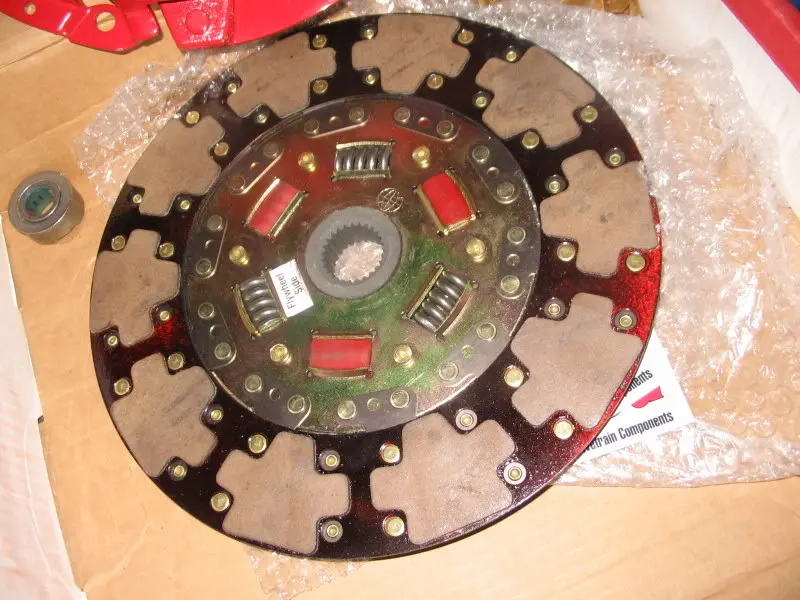

Guero, the picture that you have posted looks very similar the the opposite side of the disc in my picture. If the other side of your disc looks similar to this, then I would say that what you see in my picture is for the flywheel side (as that's what the white sticker says).

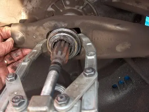

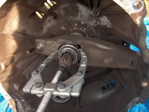

i got pics of the tob... thats all i rember going on there...
all i got bro
as you can tell... my TOB was toast.... all melted up... ball bearings sitting in the bell housing... good times
