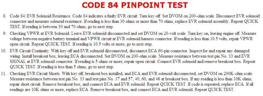

Again.... code 84 shouldn't cause the problem you're having, however, since you insist, use the pinpoint test attached.
