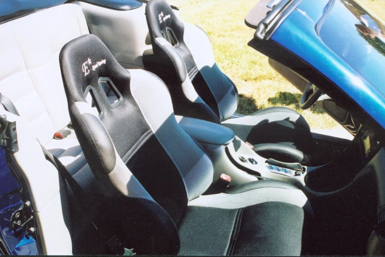

check all the bolts underneath..your seat may just be wearing out...I got my seats for under 300 for the set...and love them...hard as hell to put in, but def worth it

98stangv8> I am pretty sure you are right about the loose bolt, as mentioned above - it's just getting to it. Your seats are nice, however I'd like to keep the ones I have now, so I am not quite ready to go that route :).
