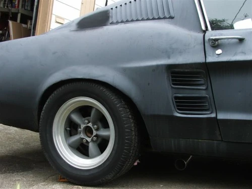

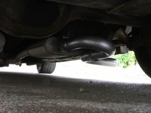

Currently, my car has JBA shorty headers w/ a 3" magna-flo x-pipe. The pipes are 3" and go straight back to spintech mufflers and turndowns before the rear axle. It sounds awesome, but i think it's too loud for the street.
I don't want to run the pipes out the back. Besides, I don't think there is enough room anyways.
So, are there any other options or suggestions? Han anybody tried Dynatech turndowns w/ the cone insert? What about realigning the turndowns to not point directly down?

Put in a 12" in line Dynamax before the mufflers. They should fit in the driveshaft tunnel with no problem.
Does amazing job and does not rob performance.
HistoricMustang
Do you know anyone that has done this? How much of a difference would it make?
Are you referring to the Dynomax 12" bullet race muffler?
I did it and it will solve the problem.
Yes, it was the Dynamax 12" race muffler. My street exhaust system also turned down at the rear axle, just as yours. It may be a simple cut and install in your case.
