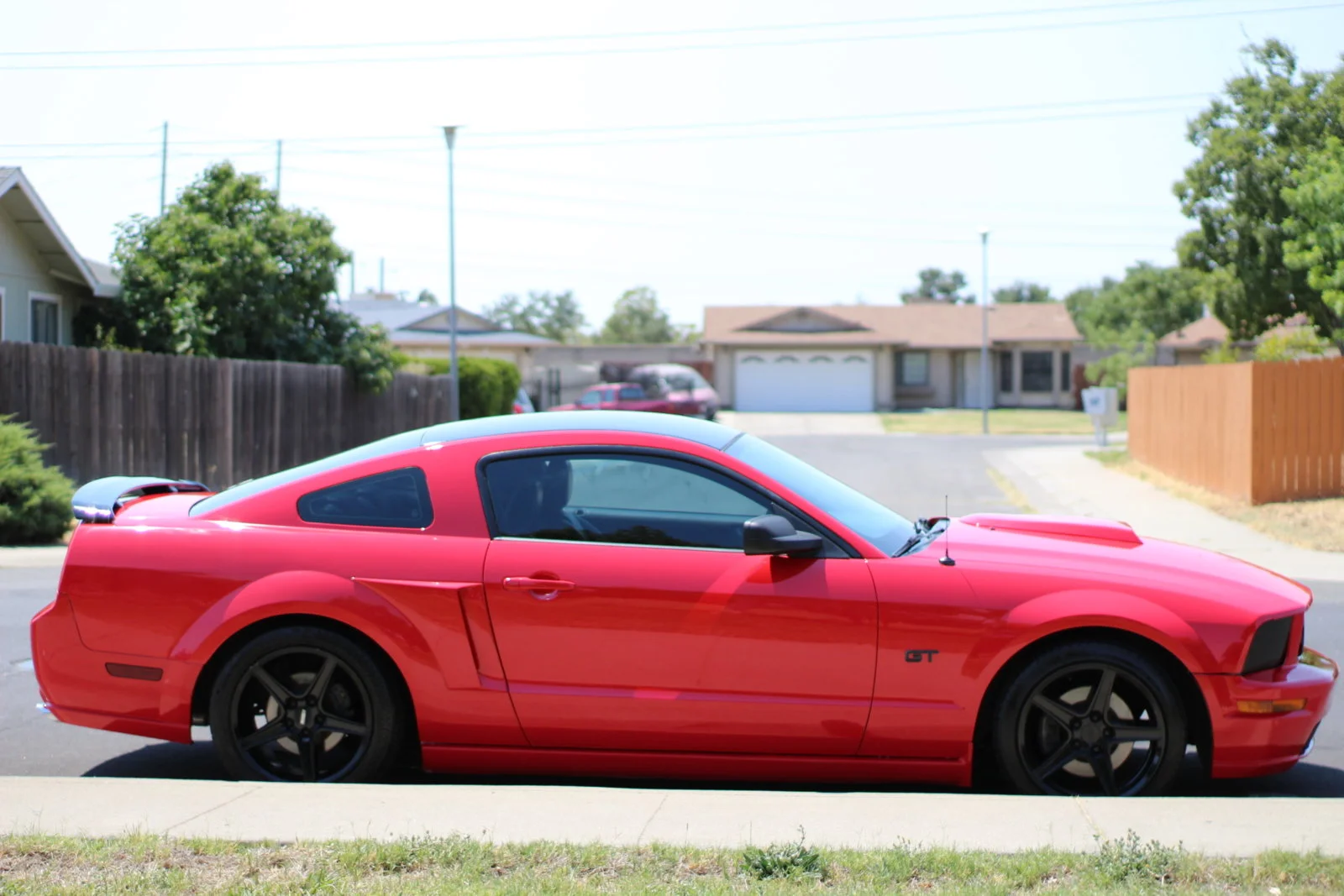

Thank you for the info, so it turned out that aftermarket 62mm throttle body(TB) mechanical mechanism needed its voltage adjusted. It's crazy because the TB has been on the car for the past 6 years and was working fine. Currently, I swapped out 62mm TB with stock TB (using all the electrical components like TPS and TB motor) the car is working fine.
Thank you guys for all the help, the pony is up and running!!!
