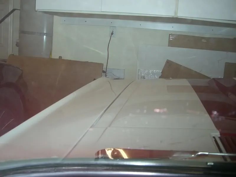

The back of the hood seems pushed down and the front seems to be pushed up
Can't really get a defining pic of the front up

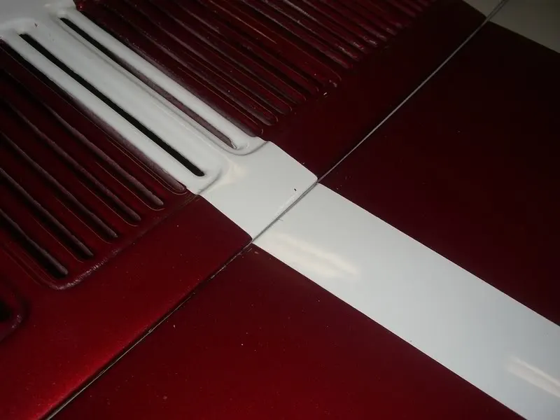

Here's the damage to the back

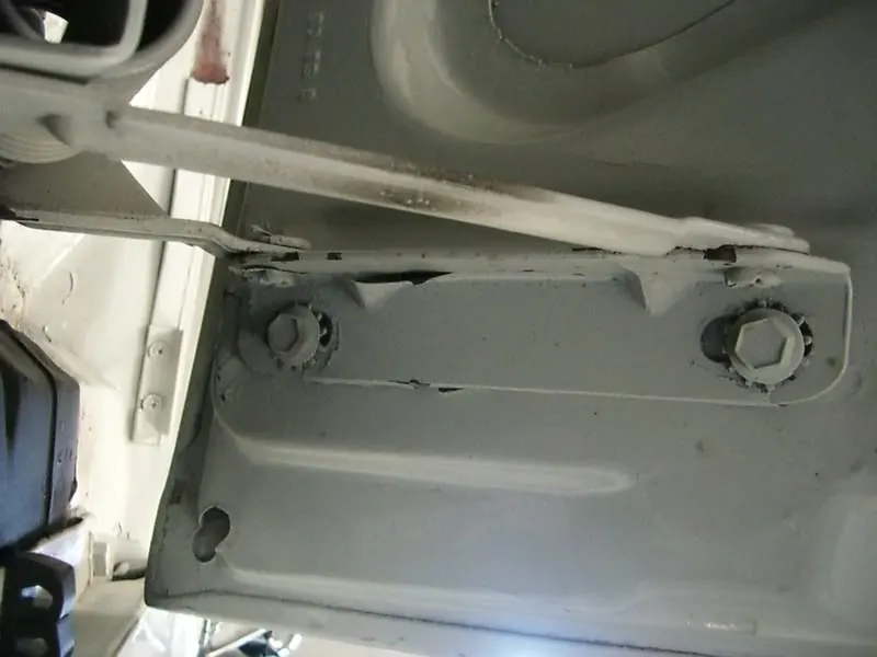

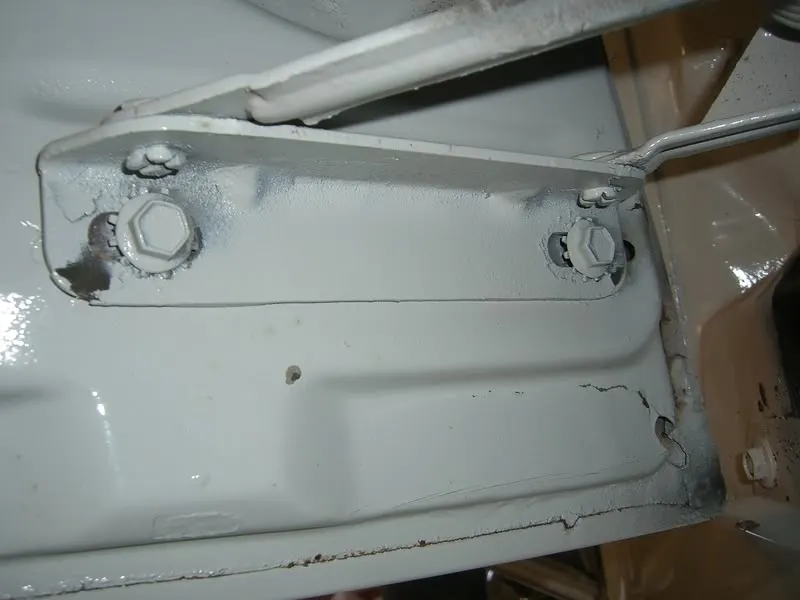

Hinges
Driver side
Passenger Side
So I think... what happened is the wind pushed the front of the hood up, consequently pushing the back of the hinges (it has 3 bolts) so i think the last bolt in the back, pushed that part of the hinge down a bit and thats why it sits in low in the back and high in the front?

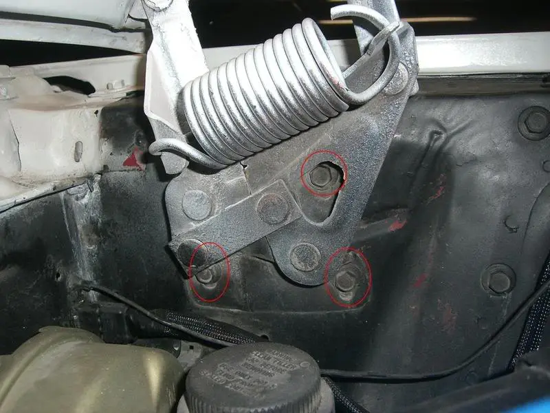

What about the other side of the hinges where the bolt into the car ? Did you check those out ?
suki243
Dec 19, 2006
662
Southern California
Feb 17, 2008
  • Feb 17, 2008
Yah i think i know where ur talkn about. It might've been pushed down, maybe the entire hinge assembly got pushed down back there.
The red circles show what i mean, You see how they're pushed all the way to the top of the hinge itself? like maybe the hood flying up did that, pushed it all the way down. Thus explaining why the back sits low and the front sits high... And why the hood rubs the cowl when opening, maybe the clearance was a little higher ?
