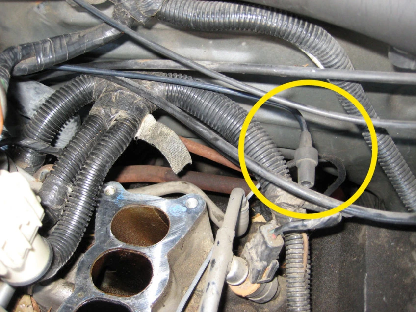

Guys, I hate to bother with something like this but I need help. This weekend I replaced the valve cover gaskets in my 89 GT. I thought I had everything buttoned up pretty good but in reviewing the pictures, I found this line that I don't recall pulling and I don't know where it is supposed to connect to. Can you please help?

Yea what he said, under the upper intake there are a bunch of hard lines coming out, it goes on one of those. Which ever one it fits snuggly on and seems to be in the right place when you put the intake on.
Thanks...I figured it out. When I pulled the intake, I did not see that line and it disconnected on its own so when I put it back I didn't even think about it or see it. And in the photo of the intake that I took, the second fitting end was hidden behind another one. So I freaked. But I found it. Thanks for your help.
