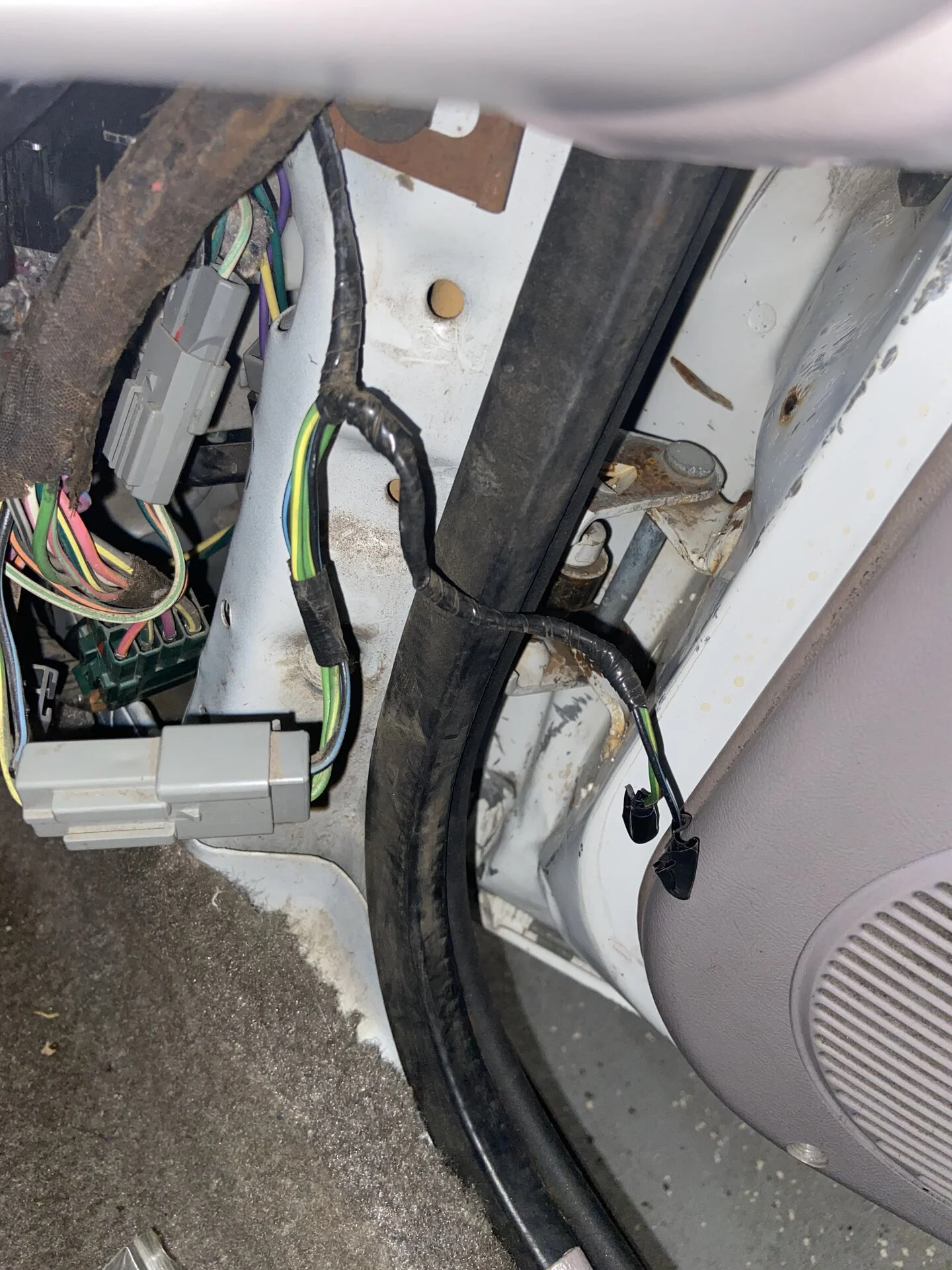

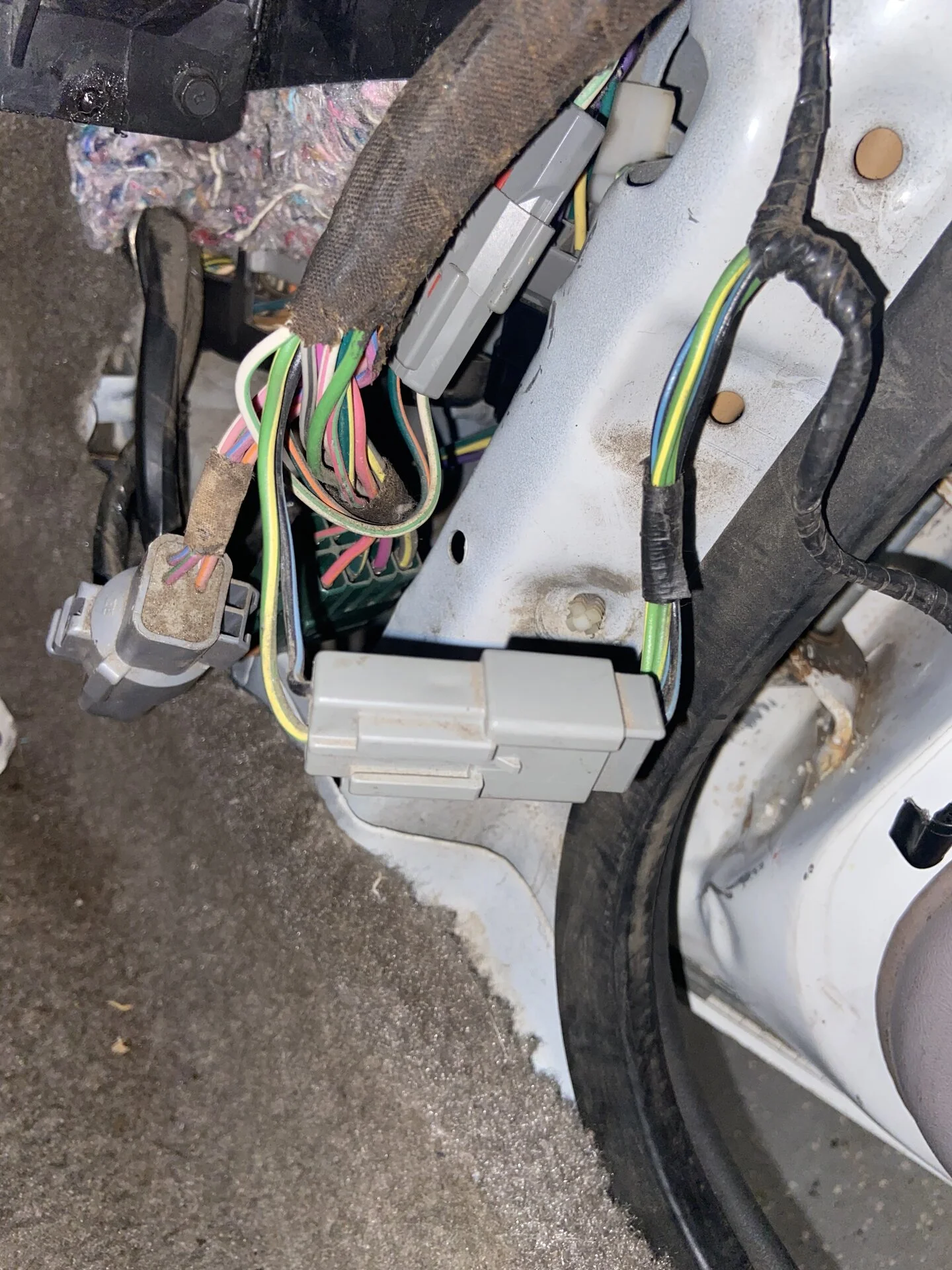

Looking for help identifying these wires. Passenger side kick panel. 1 black with blue stripe, 1 green with yellow into grey connector. 2 of each coming out. One group of the two wasn’t connected to anything and weren’t even taped off. What am I looking at?

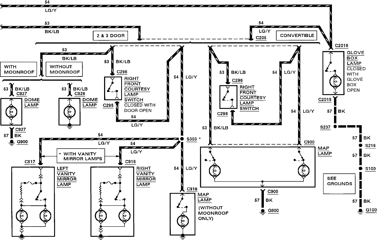

I don't know looks like probably the front right courtesy light.. see right side of this diagram under the convertible section
Awesome! Looks like it. It’s not a convertible but it is a moonroof car. So looks like it may be dome light and maybe glove box. The car actually doesn’t currently have a dome light. I think the previous owner had the headliner done and didn’t put it back in. I’m a little hesitant to cut the headliner to see what’s up there.
