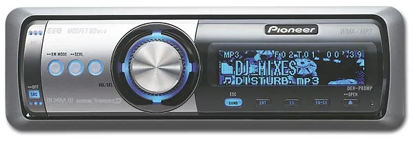

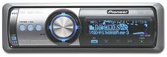

IM getting xm radio put in my new stang. but I need a new head unit think about the pioneer. O&A are back on channel 202. O&A party Rock!!!
