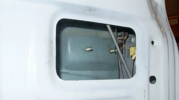

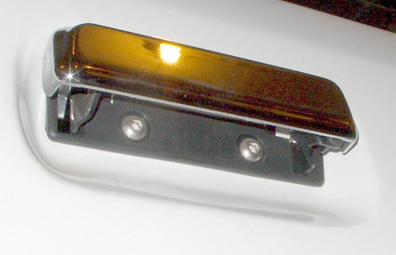

I went to my local hardware store a bought stainless steel allen head bolts and nuts. Couldn't have been easier.
