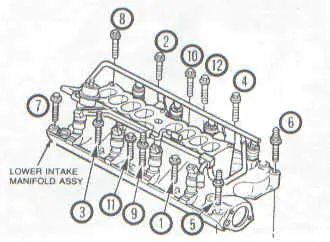

so i have to remove the intake and reinstall new gaskets? I used fel pro gaskets and i used the to rubber ones for the front and rear.
thats what i would do remove the lower intake and inspect...especially if you know its leaking at the back. you used the same gaskets as i did but mine sealed fine the felpro gaskets are good gaskets. did you use high heat sealant where the gasket meets the rubber seals at all 4 corners this is a must to prevent leaks??? the problem may also be that the meeting surfaces may not have been cleaned properly or the gasket may have slipped out of place when installing.....you will see what happened when you remove the lower.... also did you torque the lower in the sequence as listed in diagram below...and you have a 3 steps when you torque the bolts tighten all bolts in the sequence listed in the picture below to 8 ft. lbs then you start over and tighten all bolts in sequence to 16 ft. lbs and the final step you tighten all bolts again in sequence to 23-25 ft.lbs.... these steps seals the intake evenly if this is not done properly it can also cause a leak.....

you need to get a repair manual....they contain alot of good info....like stated within this thread...you can get one for about $20 at a local autoparts store....i would also reccommend getting 12 new lower bolts carry one of the old bolts to a hardware store and have them get you some new ones ensure they are grade 8 the old bolts prolly streched one of mine was streched and broke i had to remove my lower and remove the broke bolt and buy new gaskets...its well worth it to get new bolts mine cost $4 for the 12 new bolts...
