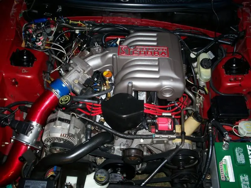

Help. Intake manifold swap gone bad.
94superstang
Apr 26, 2007
76
I just swaped out my stock intake with an frpp cobra along with a bbk cai. Since the install my car runs a little hot at normal driving conditions but when i get ont the gas it heats up. I also noticed that it doesn't accelerate as fast as it used to. So i double checked the timing and set it at 14 advanced. Still it didn't help much. I also tryed putting a 160 degree thermostat. Still the car gets hot when i floor it. I also noticed that there is a small oil leak thats coming from the passenger side. What do you think i did wrong. The car idels fine and doesn't sound like its missing. My car is stock (94 gt 5sd) except for 2 chamber flows. What do you think i did wrong?

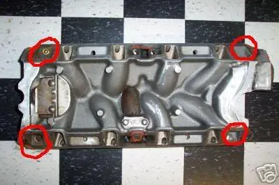

sounds like the lower intake is leaking from the back .... the back and front ports circulate coolant if these areas are not cleaned properly or if the gasket is installed improperly or moved during install it will leak.i have circled these ports in red. sounds like the problem your having is the rear coolant ports are not sealed properly....
