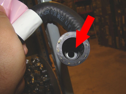

I took a piece of brass pipe plug and drilled a hole in it. Then stuffed it down the heater hose between the heater rail and the water pump. Total cost $0. Great minds think alike.

If your heater core has never been replaced then it will sooner but hopefully later. So this topic is important to all of us I guess. Does anyone have a pic or link to the device they are speaking of to lessen the pressure? I am not sure I am even going to do it, but curious..
79-04 Mustang Heater Core Flow Restrictor by Ford at LRS - Same Day Shipping!
At that price i might just pick it up for piece of mind... for some odd reason like i said, i think my car has one... but im not 100% sure untill i can take a look at my hoses... i just remember there being some sort of black clamps in the middle of the hose.

"The new Motorcraft hoses come with a coolant flow restrictor installed to reduce the chances of the new heater core blowing out the same way. If you choose to go on with your existing hoses and they don't have the Flow Restrictor we also have those available seperately."
