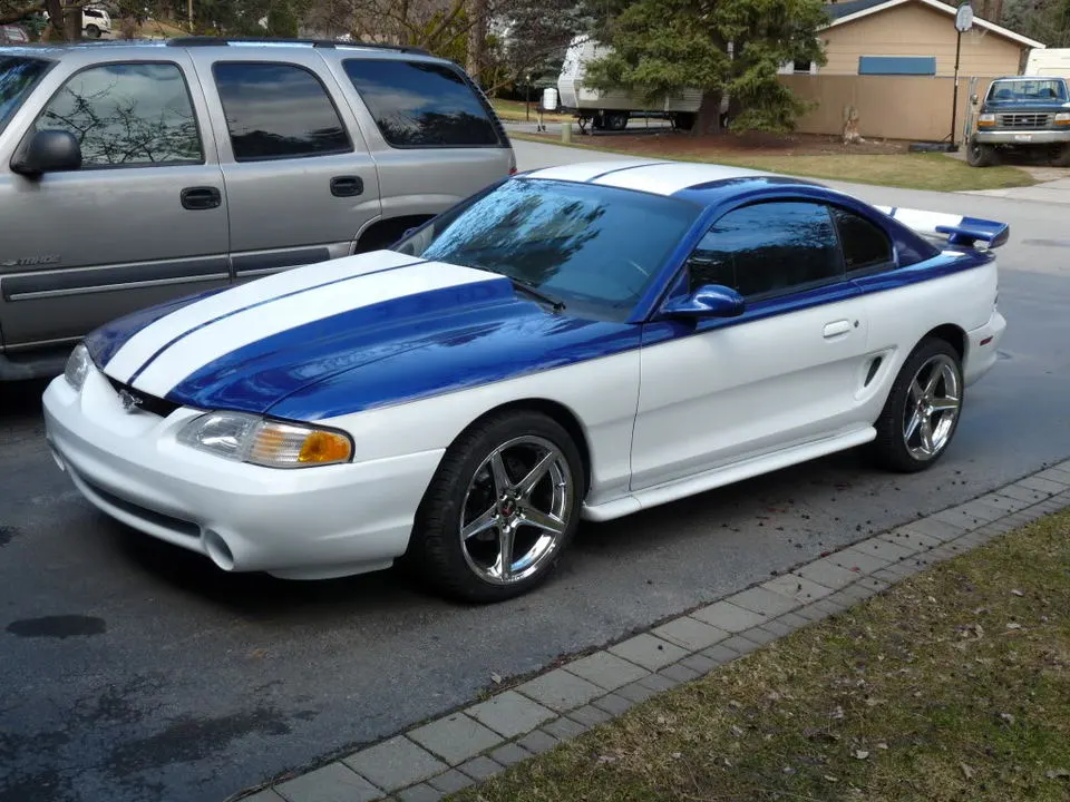

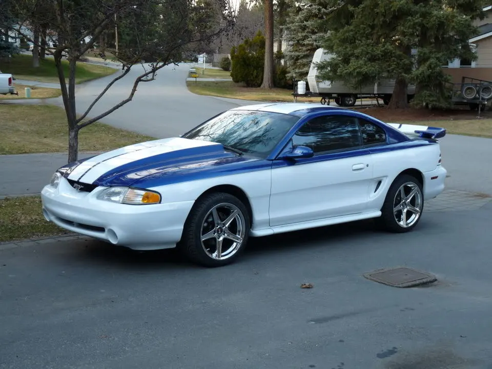

Got my front springs in today.
Before
after
