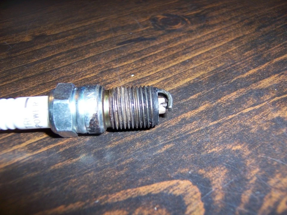

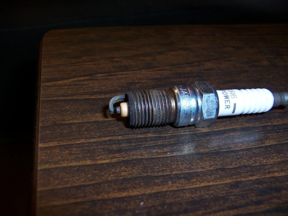

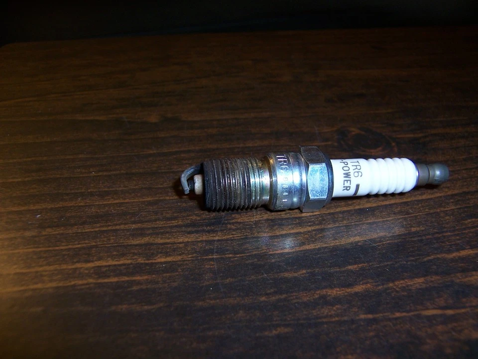

Here's what the number 1, 2, 4, 5, 6, and 7 spark plugs looked like. (i.e. normal).

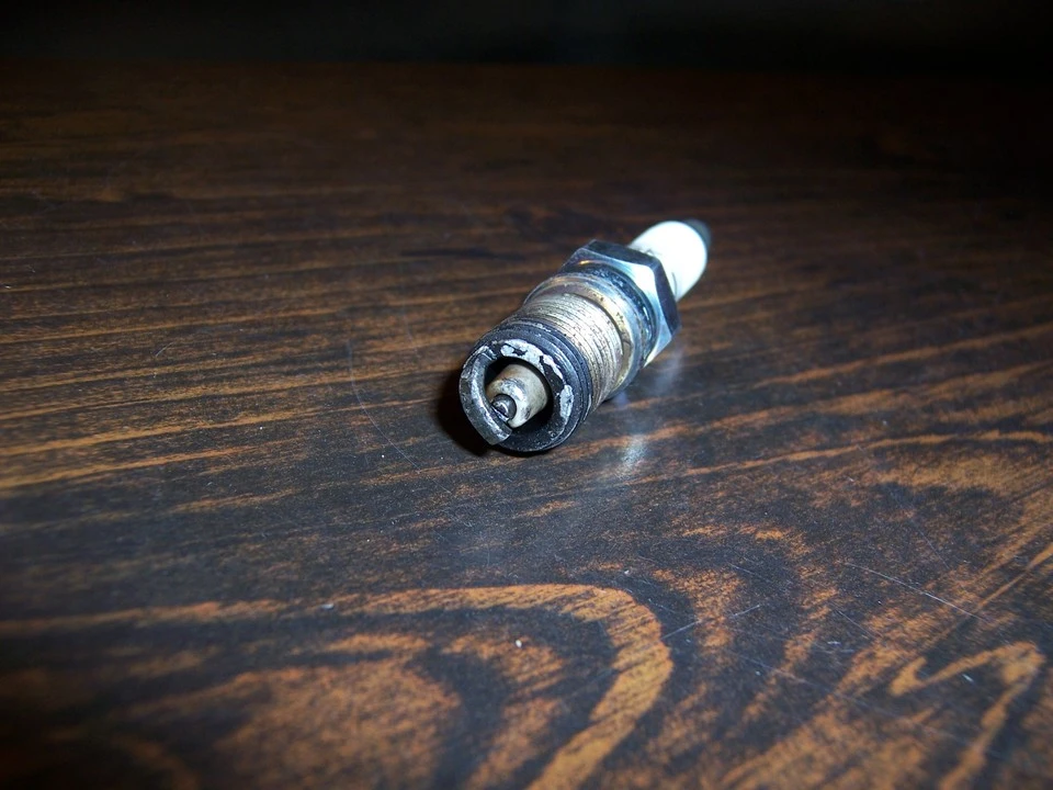

Here's what the number 8 plug looked like.

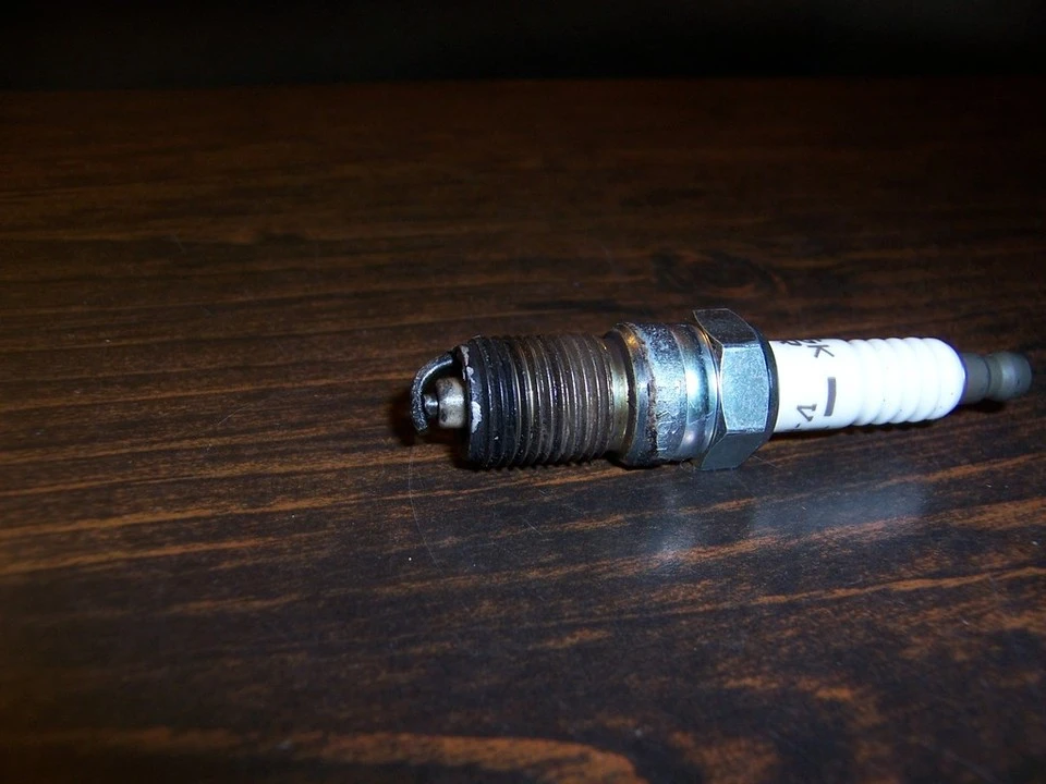

And here's what the number 3 plug looked like. :eek:
Chalk it up a lesson learned. Detonation is bad stuff. Car seems to be running fine. Is it possible that the little piece of ceramic that chipped off the #3 plug damaged anything? If so, what would be the signs?

It is possible that the ceramic piece can get stuck in a valve, or stay in the cylinder and bounce around, but you said its running fine.
If your car is running fine as you say, then the ceramic pieces (under compression) broke into little pieces and shot out the exhaust manifold.
Man, you dodged a bullet, could've stripped the threads out of your cylinder's head.

Well now, if you look at that #8 plug, you can see that the ground strap is closed up, but it's barely fouled any worse than the rest of them. That leads me to think that while it's closed way down, it was still firing at least most of the time. BUT, I can't help but think that that can't be good for the power output. How much? Who knows, but it has to be some amount. I think that that plug got damaged during the tuning session, and then the #3 plug got demolished during the detonation yesterday.

i would be willing to bet that those plugs were probably not like that during the tune. i wouldnt be surprised if while it was being tuned that something happened that may have been a precurser to that. perhaps just a lil bout of det during a dyno run, closed the gap slightly and caused NASTY failure during a run at the strip?
hopefully that tiny piece of ceramic just flew by your exhaust valve. it probably did. there is a guy right up the street from me that has a procharged 95 gt that is built and runs 10's, before he stepped up to a procharger he was running a powerdyne centri with an experimental impeller and the whole damn impeller disintegrated. it blew 1/8th inch pieces of the impeller all the way through the motor, out the exhaust, and on the road to be picked up... it didnt even nick a valve.
Yea, the #3 plug was DEFINITELY not like that during the tune, haha.
But the #8 plug has virtually no fouling at all (i.e. it was still firing most of the time, even though the gap was closed virtually all the way down), which would make me think that it could have been like that for a while. And the fact that changing the plugs cleared up the slight miss from after the tune means that something involving the plugs was not right after the tune. The other 6 plugs all look perfectly fine (they are only about 6 months and 8000 miles old), which has lead me to believe at least something was wrong with the #8 plug before yesterday. :shrug:
