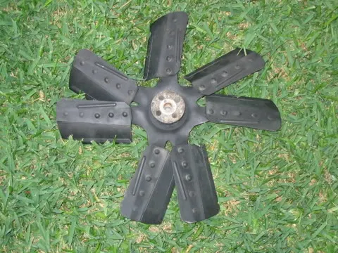

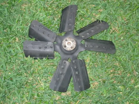

This is the exact fan I have that was attached to the water pump. As you can tell this fan without a shroud does not do much to pull air through the radiator, especially in traffic. Living in Houston makes it near impossible to drive anywhere without hitting traffic.

Appears to be the correct fan.
The shroud attaches to tabs near the bottom of the correct II-specific radiator, and 2 holes near the top on the flanges at the sides. The lower slots are provided so you can start the bolts and slide the shroud into them, and then attach the uppers. Uses 4 fender type bolts (with captured washer) and 4 "U" nuts to thread into. Some have been found with short sheetmetal screws and smaller "J" nuts.

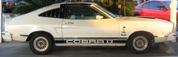

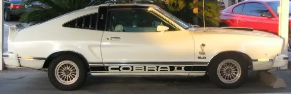

Here's a pic of my stang btw:

Nice looking Cobra, I don't think I've ever seen rims like those. I had overheating problems on my Cobra as well. I would get really nervous when I had to sit at a light too long in the summer. The fan shroud makes a huge difference and you might also check your thermostat. Sometimes they rust and can hang open or closed.

Those are actually Shelby rims. I haven't the faintest idea how they ended up on my car. I really want to get rid of the tiny wheels but that's on the back burner for now.
I know exactly what you're talking about. This car was my daily driver for a year. The overheating was huge problem except in December and January. Then there was the time I went without a speedometer cable for a couple months and got to guess how fast I was driving. Or the time one of my transmission lines rubbed a hole in itself and I could tell where I'd been by following the trail of transmission fluid.
