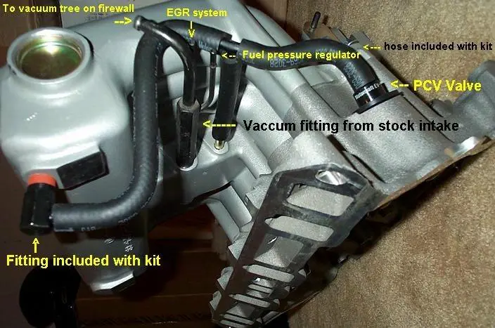

I have a new GT40 lower and cobra upper that I am about ready to mount but I need a little help identifying the openings on the intake. I have marked the openings with numbers. If anyone can help I would appreciate it. I have never torn down a 5.0 and would like to understand it before I do.

Those are all vacuum nipples except for the EGR location. Simply hook up what you need to and plug the rest. Brakes, A/C, EGR, Vapor recovery and PCV all use vacuum.
But what about #2 and #8, they are just threaded holes. Is there something that threads into them? Or, should I just find some 1/2 npt plugs for those holes? I know there are people that take these intakes off all the time. So please give more help.
This should help you
