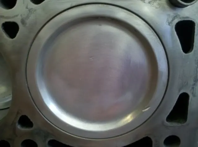

nickmckinney
Sep 25, 2009
164
May 24, 2010
  • May 24, 2010
I won't name names, but you can see what some cams do to your pistons and valves in this thread:
Ed's cam swap ordeal
And here is a picture of the lovely piston notches stock valves make:
Surging/stalling! problem or tune?
