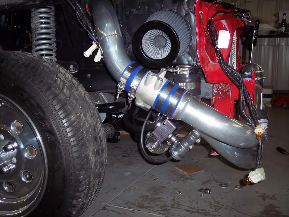

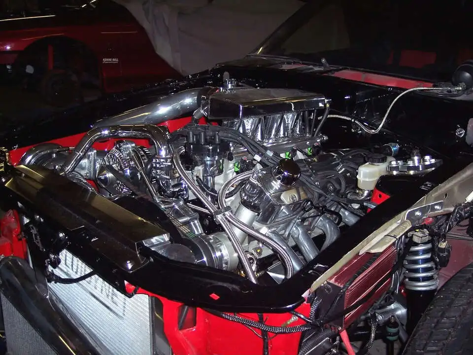

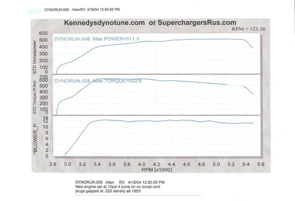

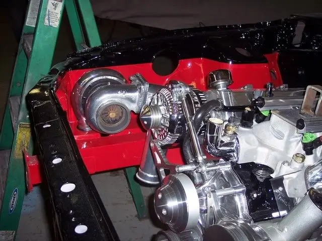

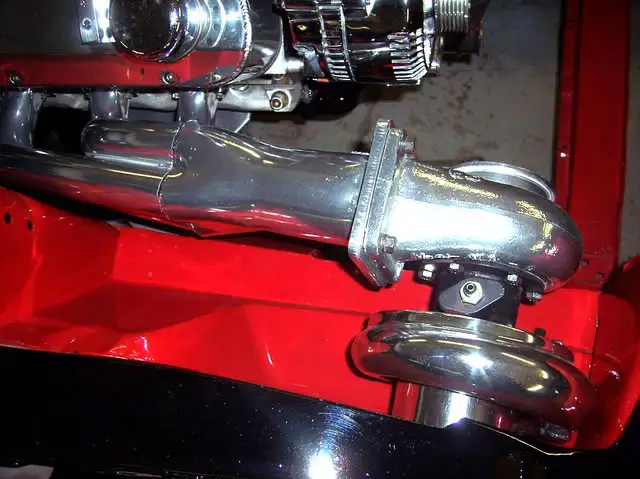

I have been running the HP t60 set up for 5 years now. I have over 25k miles on the set up. I think it is possible to use the stock block if you aren't too greedy and you know your air/fuel at all times. Absolutely purchase a good air/fuel meter(Innovate is an excellent one). Also if you go with HP get their custom cam. I'd be glad to help you out with info, just pm me. I would recommend the 331 over the 347. I had mine torn down over the winter so I could send my tubing back to get re Jet Hot coated under warranty with HP. Here are some pics of the kit...
here's the dyno sheet with my old set up, haven't dynoed with the Trick Flow and Hogan components yet, but am expecting better #'s.

wow! I'm not really a fan of chrome.. but that looks sweet. So what is your opinion of HP? Everything go smooth with them? Is the DSS block anything special? Stronger than a stocker?

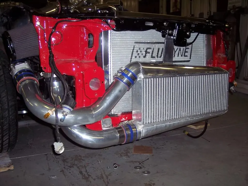

Another question.. do you feel that the intercooler provided is sufficient? I just ordered a Snow Performance Stage II Boost cooler for my wifes XR4Ti, do you think something like this would help?

Thanks, but nothing under there is chrome it's the new" Extreme "jet hot coating or aluminum, chrome makes heat=not good. Yes, the intercooler is sufficient. I think the HP kit puts up good #'s but I can't dispute the problems with deliveries. I didn't really have any problems with HP, but i have heard of some that have. There wern't all the choices for good kits five years ago like now. I got the Level 20 race prep DSS, but it's still a stock block basically. Good luck.
