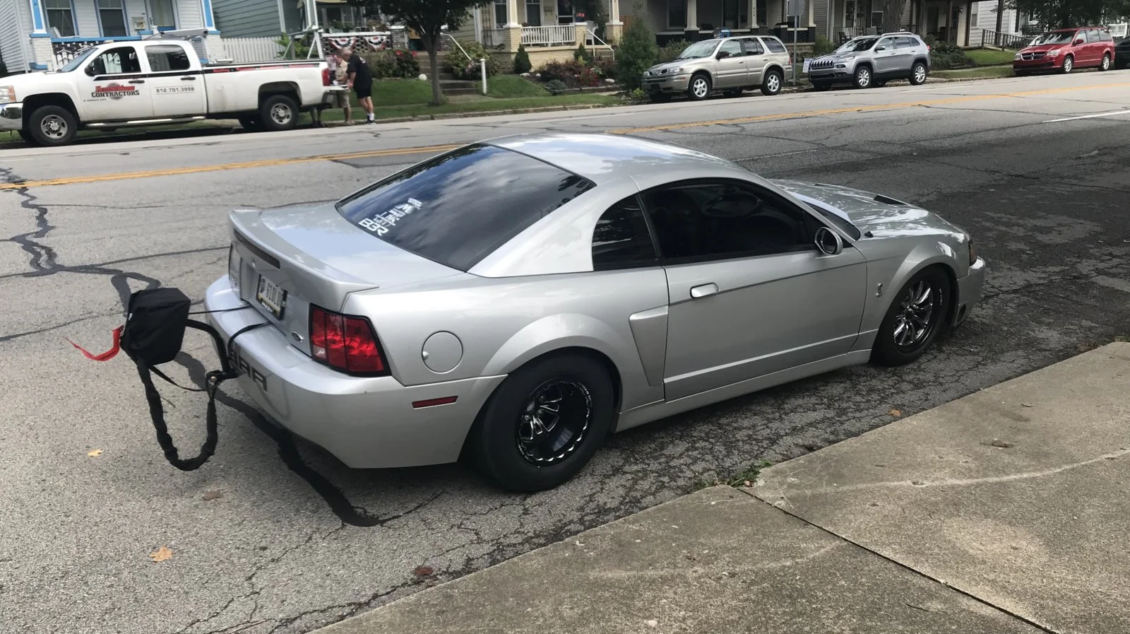

Decided to drive the car 15 miles “into town”.
Drove great, etc etc.
Unfortunately car shut off when I got downtown. Thought the kill switch circuit opened but turns out the battery connection came loose. No big deal. Pulled over to reconnect. Wouldn’t start. Chased down all the connections, tried to jump start it, even swapped the battery. No start.
ECU had power, dash had power, sensors all read, fan ran, etc.
Stuck...

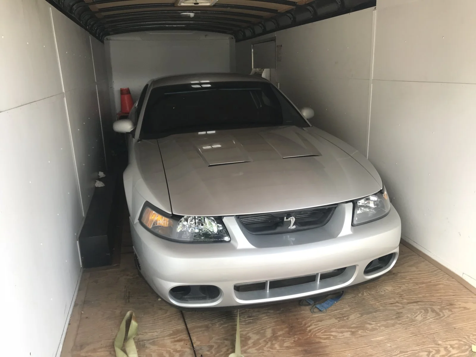

Had a buddy come pick me up with his trailer and took it home.
Pushed it out of the trailer and into the garage. I said “wouldn’t it suck if it fired right up after all that?”
It did...
Thinking starter failure

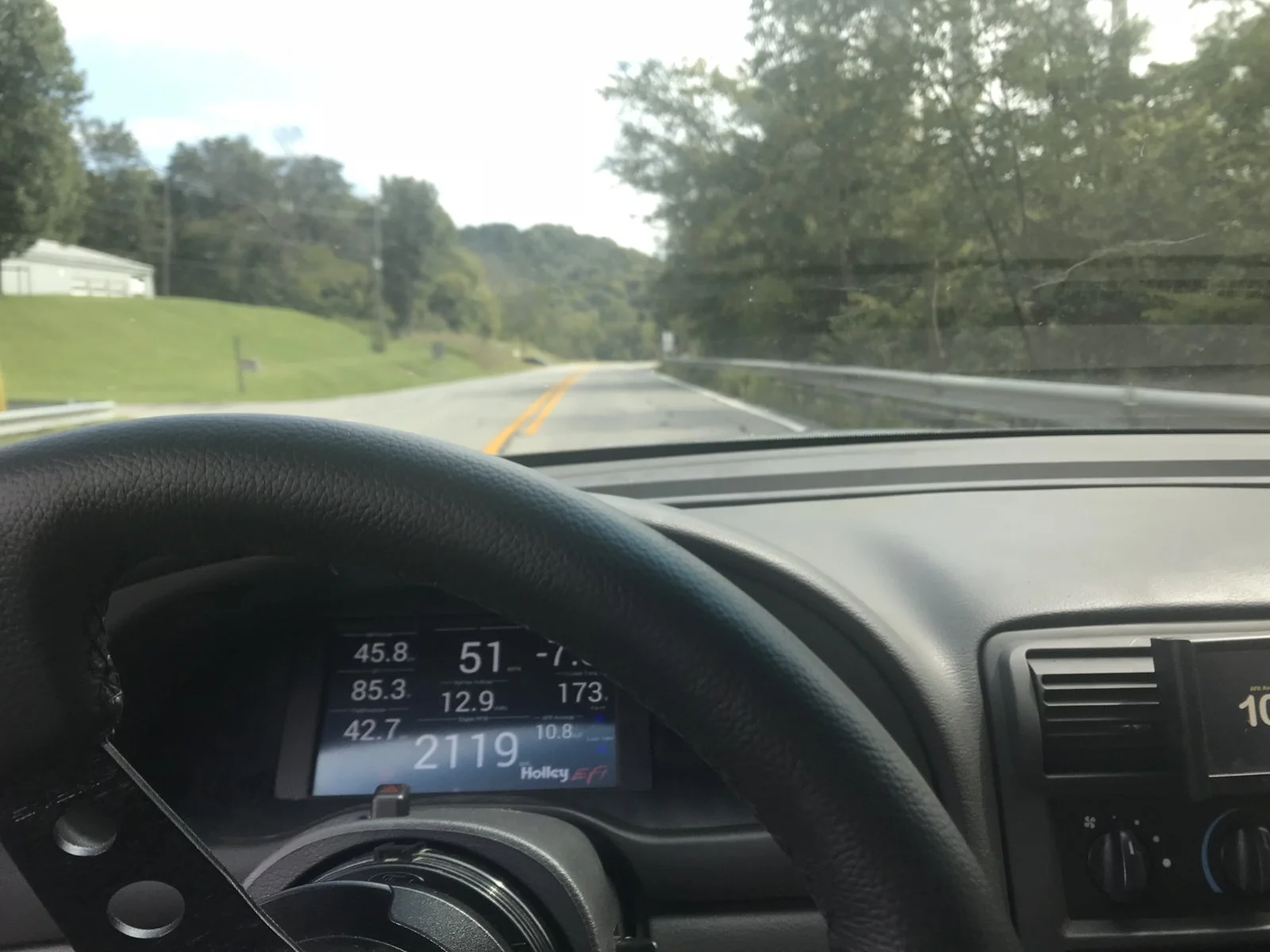

Unfortunately, no Lambda display tables with Holley yet. Thought we would get it with v5 but apparently not. I would switch immediately if so. Must simpler for my brain.
It’s tuned for e85 but uses the gas scale. Target AFRs are adjusted accordingly, which I believe was your concern. It definitely reads fat compared to gasoline. It’s still using lambda to do the work in the background but choosing gasoline or e85 in the configuration just changes the multiplier used, which i know you already knew. This tune file came from a dyno tune of the same engine/trans/turbo/fuel combination, i just changed the injector data and rescaled for my map sensor. Seems to be working great after some small changes and driving it around a good bit. Idles a hair too high but i think that’s the throttle stop adjustment from when I was having regulator issues.
Im confident i could fill it up with pump 93 and shift the AFR table up and drive it home if i has to. Didn’t feel the need to use a flex fuel sensor and have to set up an advanced table to adjust. It should be doing that work when working towards the target AFR anyways, no?
