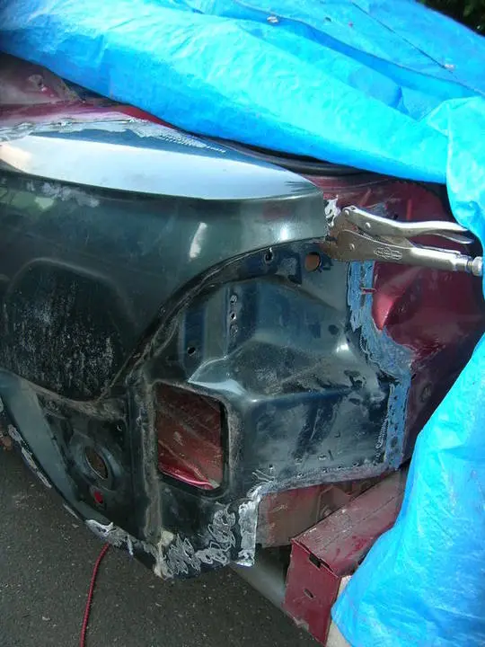

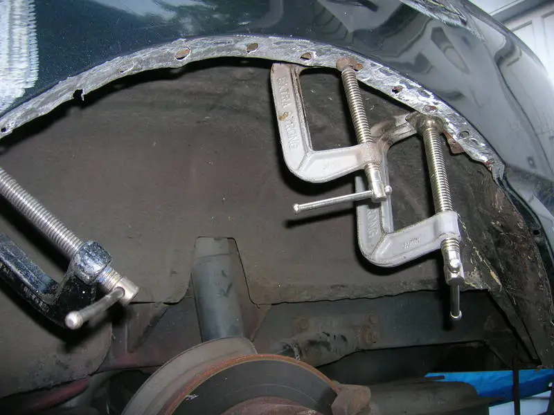

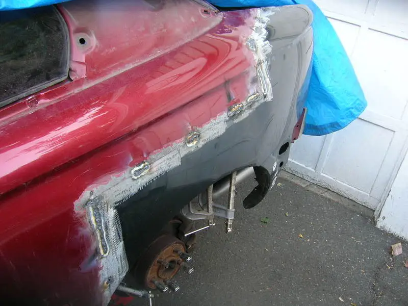

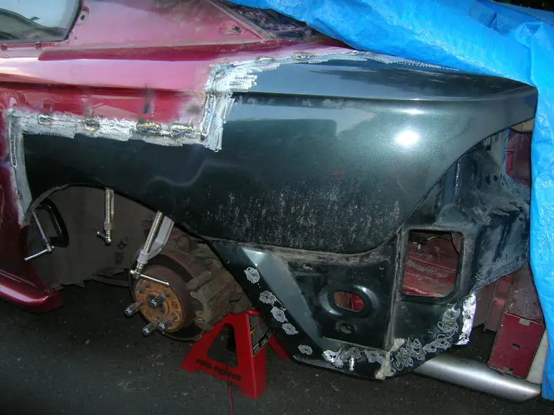

Update: Here's the pics I said I was gonna get. We still have some more welding to do before we start grinding and getting ready for bondo, but we made a ton of progress yesterday.

I'm not entirely sure what you mean by "flange" the patch panel. Do you mean making the lip go in towards the car a little so the body filler will have more room to sit in? If so, yes we bent the metal in a little bit before we started the welding. I'm not too worried that we can make this car come out nicely, it just takes a lotta patience. All you guys that keep telling Nate to bring it to someone obviously can't read very well because he clearly stated multiple times that he was going to do it himself. Anyone can do any project they set their mind to if they take their time, and do quality work. Obviously neither of our cars are going to be as perfect as if a body shop did it, but I don't have $700 bucks to spend to have someone do something for me that I can do myself.

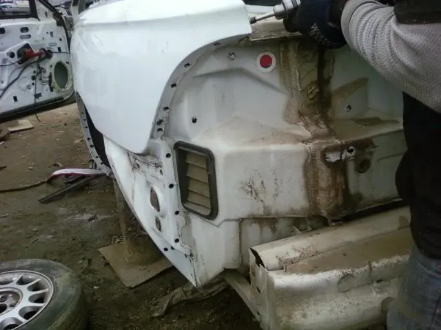

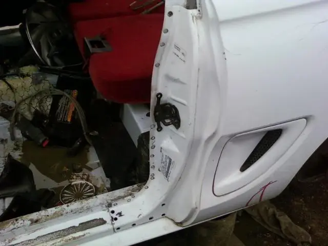

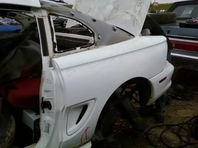

so went to the JY today.found a 1/4 panel in pretty good shape.some light scratches,but no dings or dents.

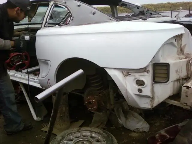

removed bumper,taillight,trunk lid w/hinge,and interior trim panel to expose all spot welds.

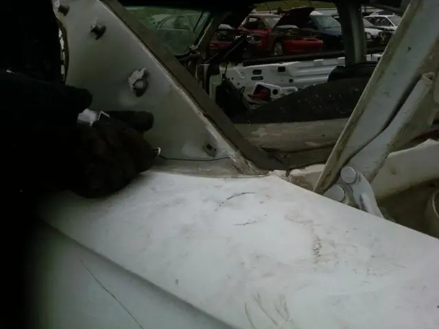

i cut here so the weld will be hidden behind the sail panel when i put it all back togeather.

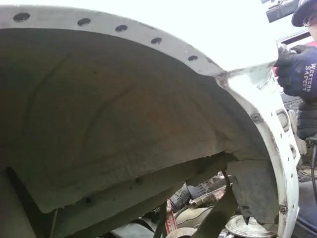

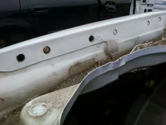

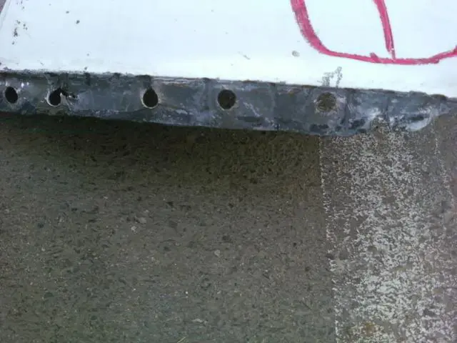

drilled out the spot welds along the edge only,there are a couple to the right of the latch,dont drill those out.
drilled out the ones at the edge of the wheel well.

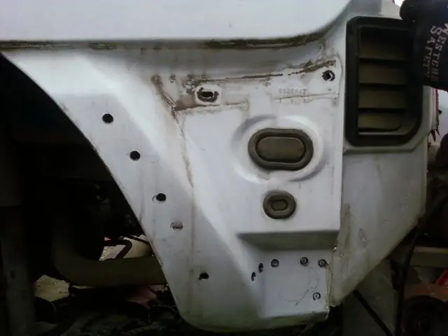

as well as those behind the bumper,
taillight.
and along the top edge that is covered by the trunk lid.

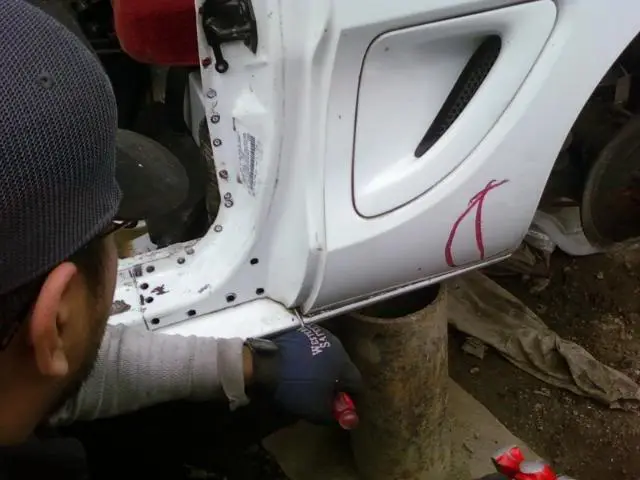

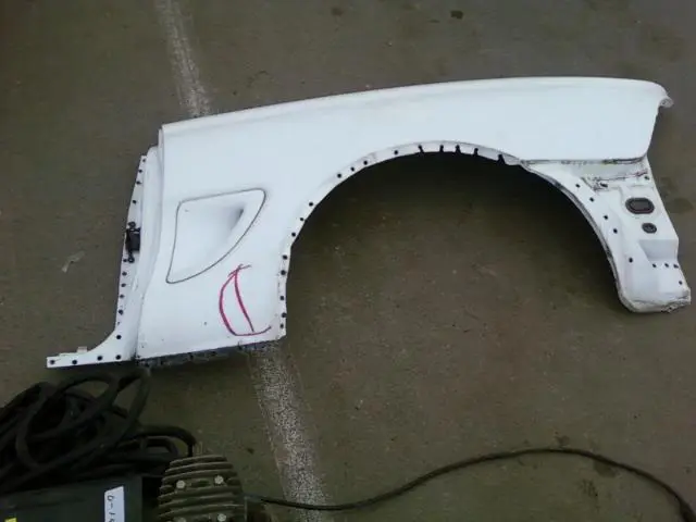

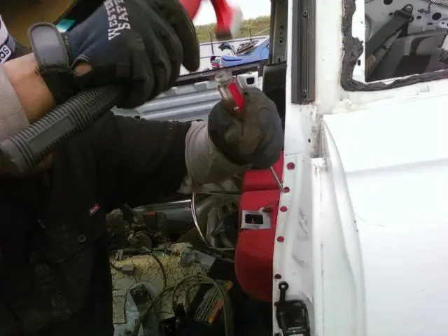

after that,i used a hammer and screwdriver (i know,not the right tools.) to seperate the 1/4 panel from the inner panel.
went well,but what i did not know was there are 5 spot welds holding the lower portion on(by the red mark)
after getting the top portion free,i pulled it back and drilled them out from the inside.

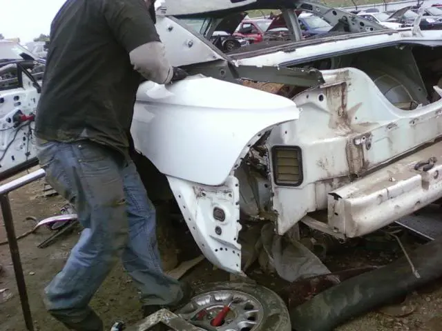

heres how it came out.
