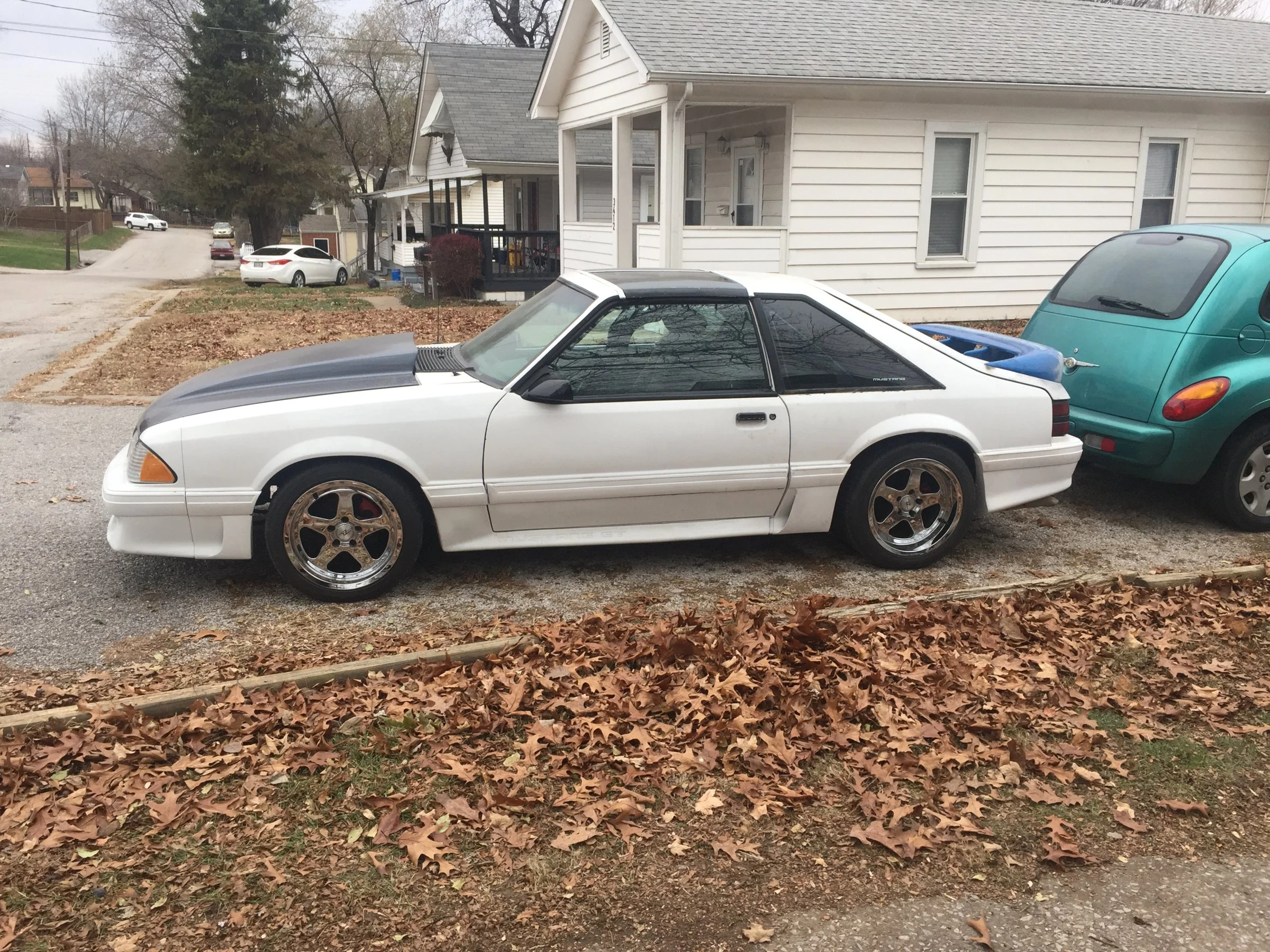

I feel like I about got it under control at this point. Make a bleeding tool out of a bottle and hose. Ended up bleeding my buddies car cuz his brakes went out.
I'll try to get to mine tomorrow.
At least she's fun to look at.

Good look'n car and t top to boot.
I prefer to look at my car vs drive it
Nice job
Sent from my iPhone using Tapatalk
