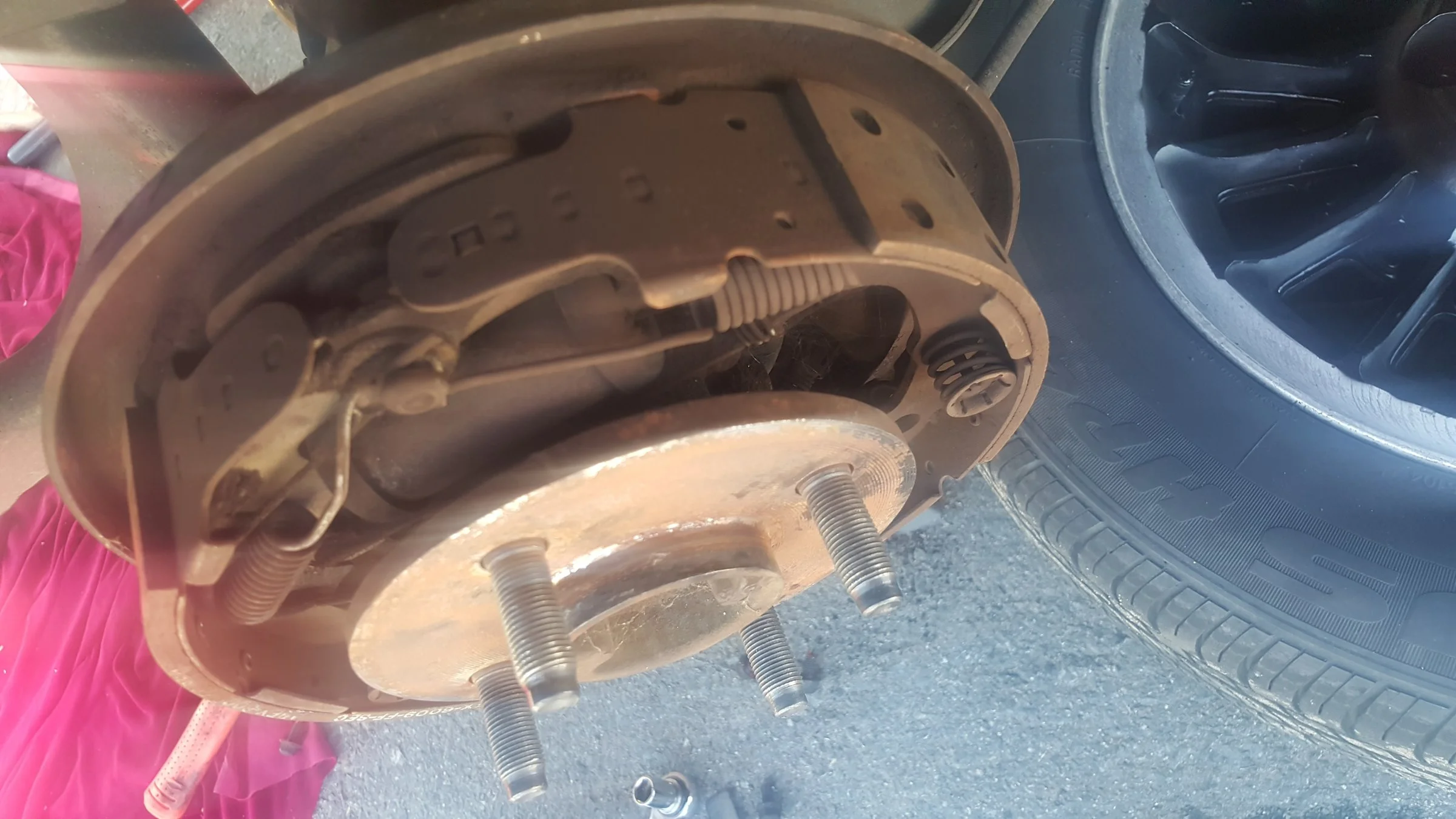

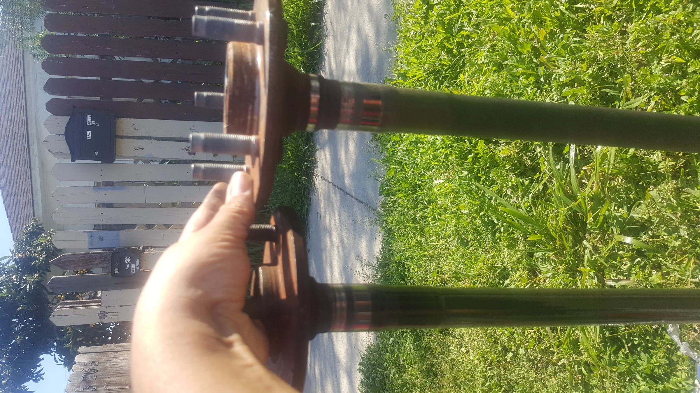

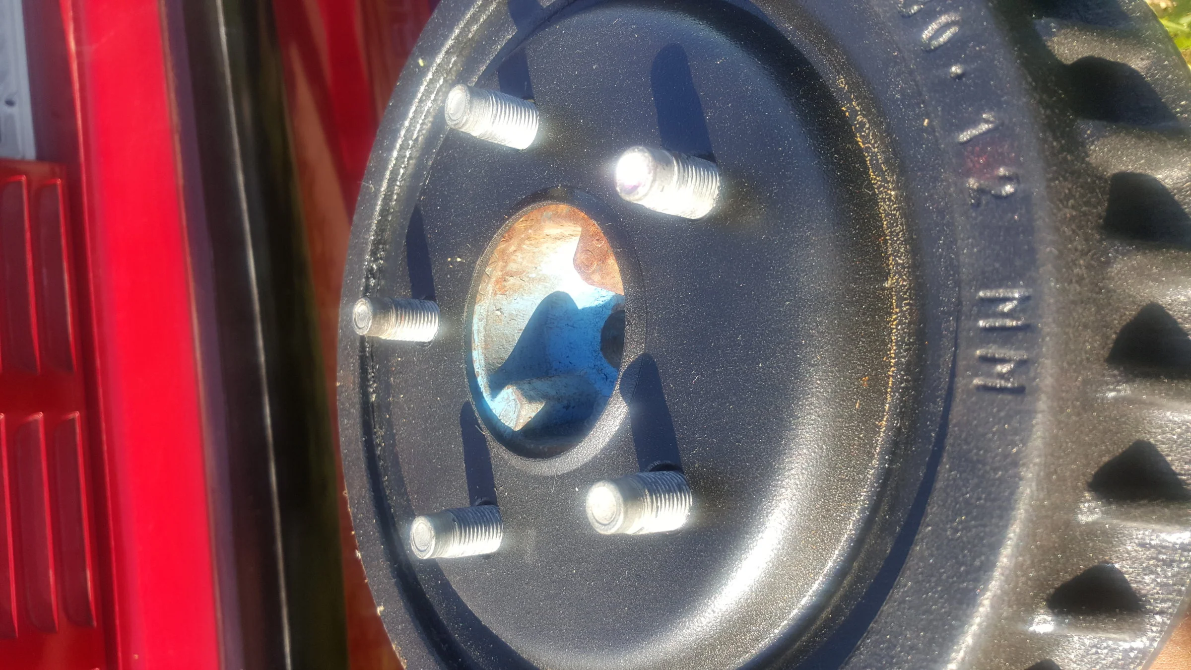

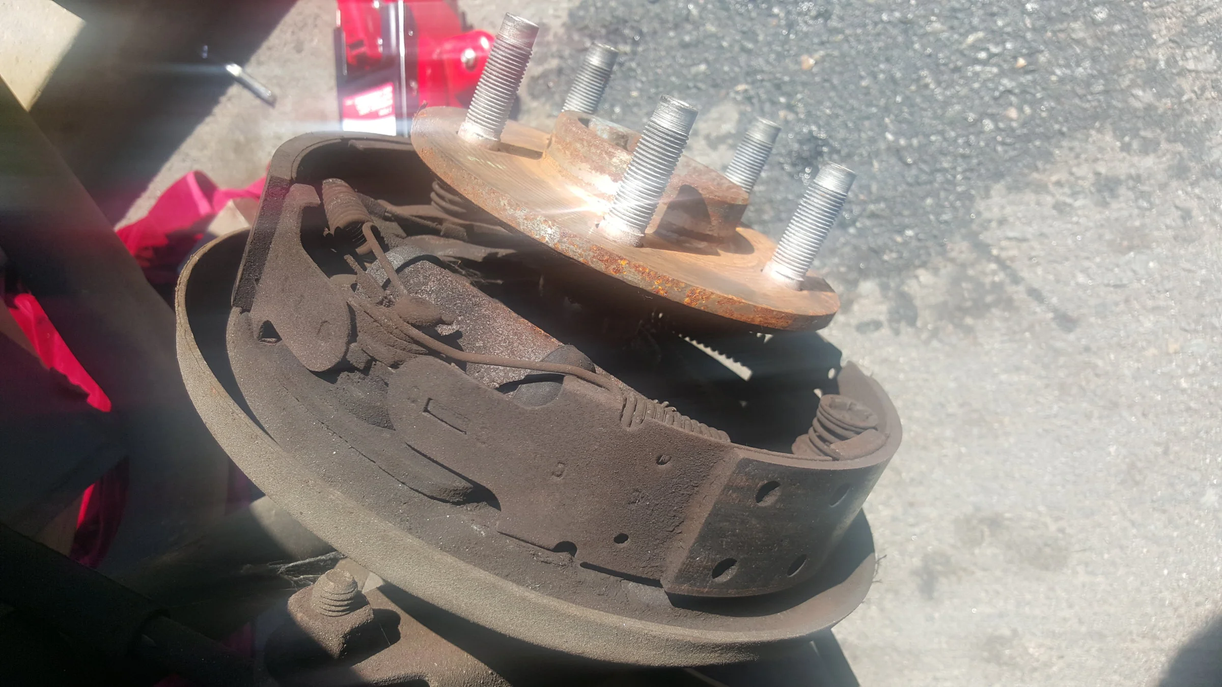

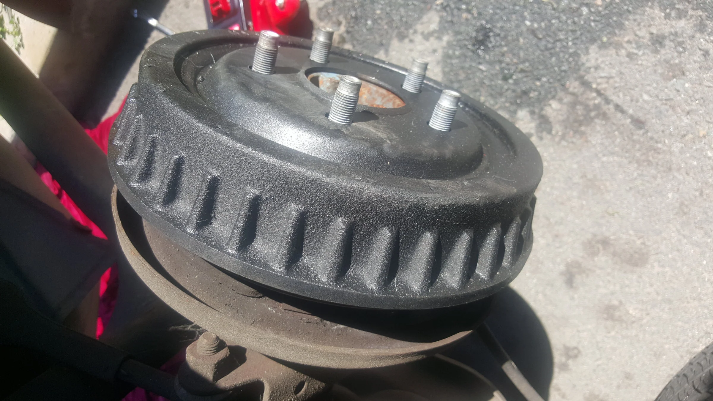

hi, thanks for looking
i removed the axles from my foxbody, I'm trying to install a pair from a newer mustang. ..can't remember the year. they are too long....I'm not sure if I can replace the wheel bearing? or what?
thanks

Wheel bearing won't relocate the face of the axle which determines your drum placement. Your options are to switch to SN95 rear disc brakes, or go back to shorter axles.
