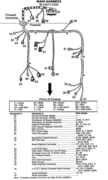

i have a 87 gt, that im trying to change over to mass air.. i got everything out of a 91 mustang. i changed over all the wiring harness and the computer, and all the mass air parts..
1-there is one plug down by the computer that was not on the 87 harness..what does this plug go to?? ( I've been told that its for the airbags and not to worry and it) but i dont know..
2-when i got everthing hooked up (besides that plug by the computer) the fuel pump wont come on..
has anyone done this, and what all do i have to do??? thanks
If something is not grounded the fuel pump wont prime, may want to look at your connections again. I have no idea about the extra plug though. Could that be a ground, or is it an actual plug.
Did you swap the over the entire car wiring harness or just the engine harness? If you just swapped out the engine harness your car WILL NOT WORK.
If this is the case then the easiest thing to do is just add the maf wires to your original harness and change the few pins that need to be changed as well. There used to be guides on here and on corral about which pin positions have to be changed on the plug that goes into the computer.
Good luck.

The extra connector may be for the Mass Air Sensor.
The following is typical of the mass air harness. It may or may not match the one you have.
See the following website for some help from Tmoss (diagram designer) & Stang&2Birds (website host) for help on 88-95 wiring http://www.veryuseful.com/mustang/tech/engine/
