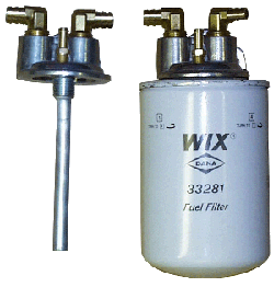

I pulled this image off of one of the supporting links from Håkan's site.
Doen't this look like a modified external oil filter adapter?
