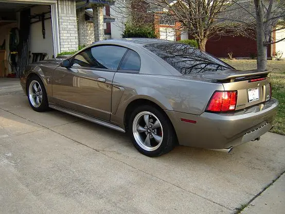

I have this setup myself. '01 V6 with Bullitt take-offs. No clearance issues whatsoever.
The SN95 Bullitt wheels are standard 17x8 with the same five-lug pattern found on all SN95 V6s, GTs, Bullitts, and Cobras. Even with my BBK lowering springs they don't rub. Just remember that when you are switching from 16" to 17" wheels you need to adjust the tire aspect ratio so your overall circumference is the same (preserving your speedometer accuracy).
