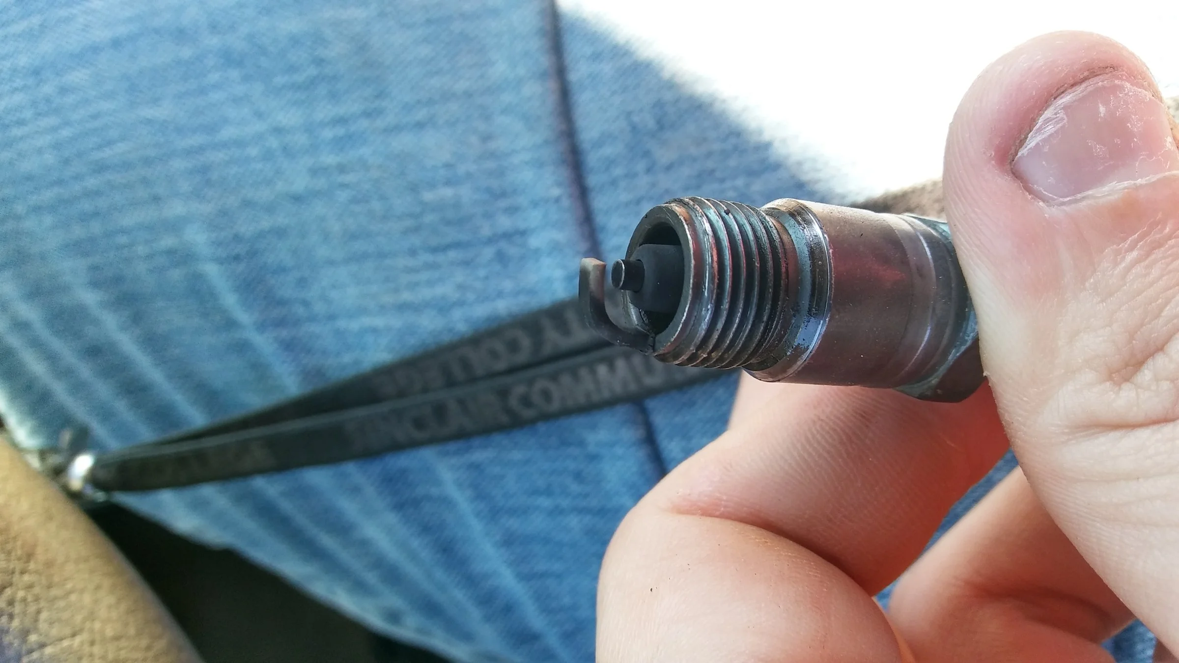

Here's one of the new spark plugs I just put in.

The idle won't change much if you disconnect that little vacuum line, but the fuel pressure should change. Have you put a gauge on it yet? That's probably the most important place to start based on your symptoms.
