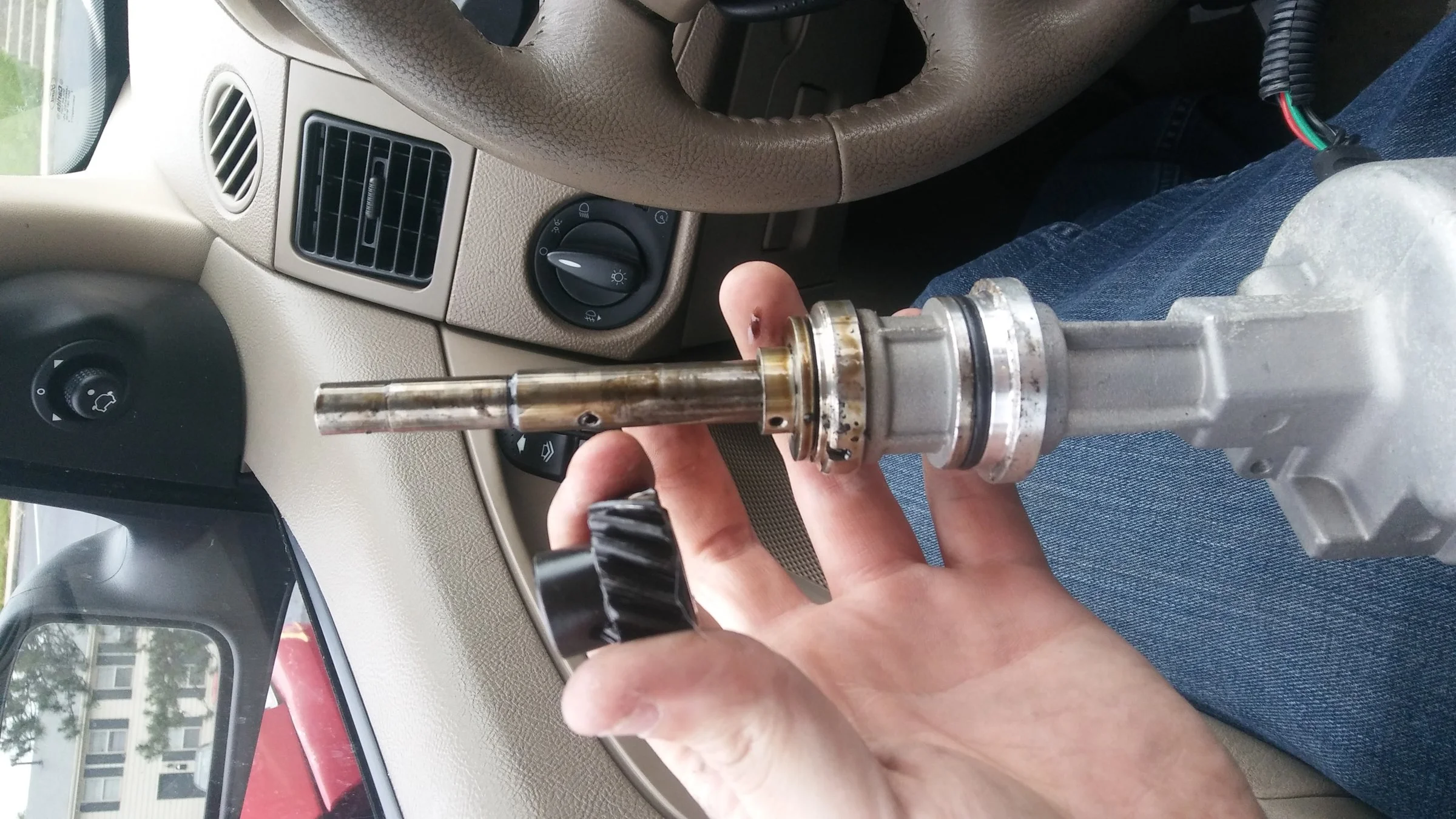

well guys i think i have "MAYBE" found the culprit... i just pulled the dizzy and i heard a clunk noise.... i looked at the dizzy and the gears pin that held it in snapped.... would this possibly be my issue? the thing that i'm confused about is that it would run. not well but it would run. but yesterday i tried to crank it and adjust the timing to see if that would help but no spark. would this cause erratic numbers from the timing light? btw the guy whom i bought the car from sent me to autozone to trade it in so thats $100 that i can save towards something else.

Suggest you check your oil pump to make sure it has not jammed. Sometimes a piece of a valve stem seal or other debris can get past the pick up screen and jam the pump.
If you can spin the pump with a shaft it should be OK.
Took a lot of force to break that pin.
I'd only add that if that in fact happened, you'll want to change the pump and the shaft as well.
