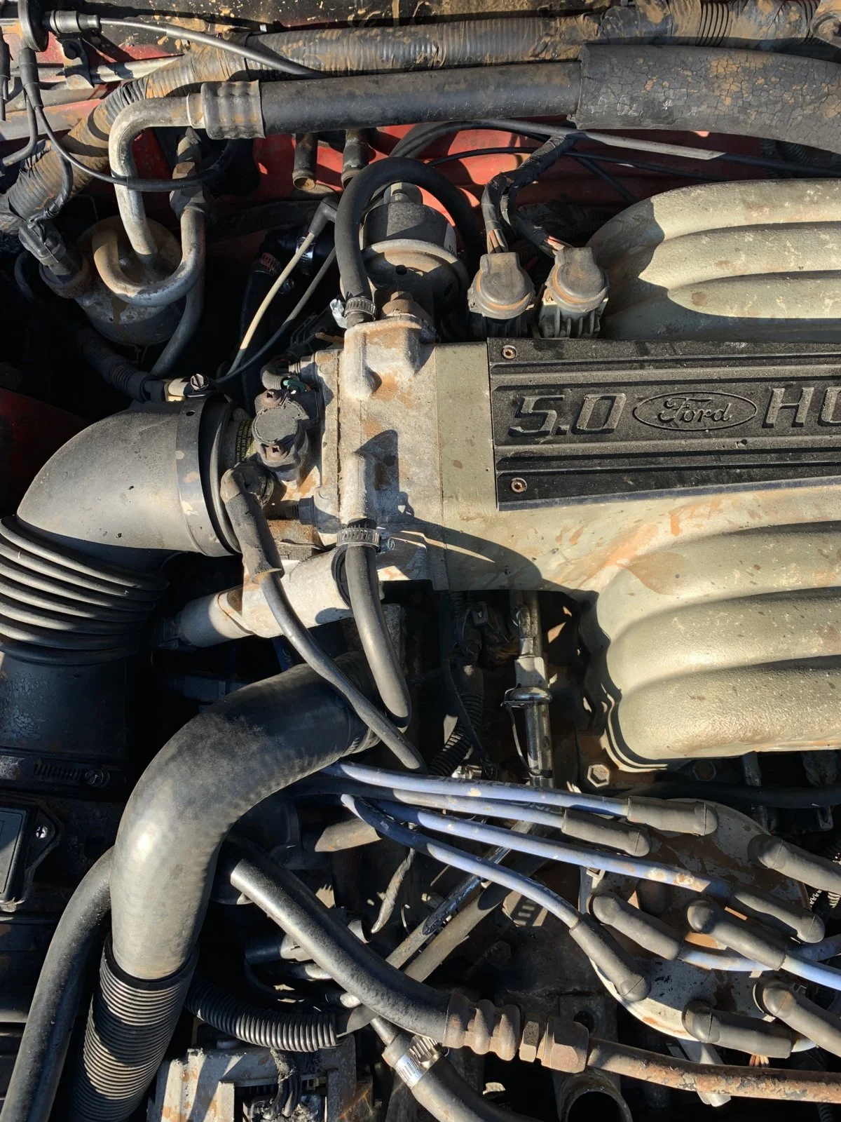

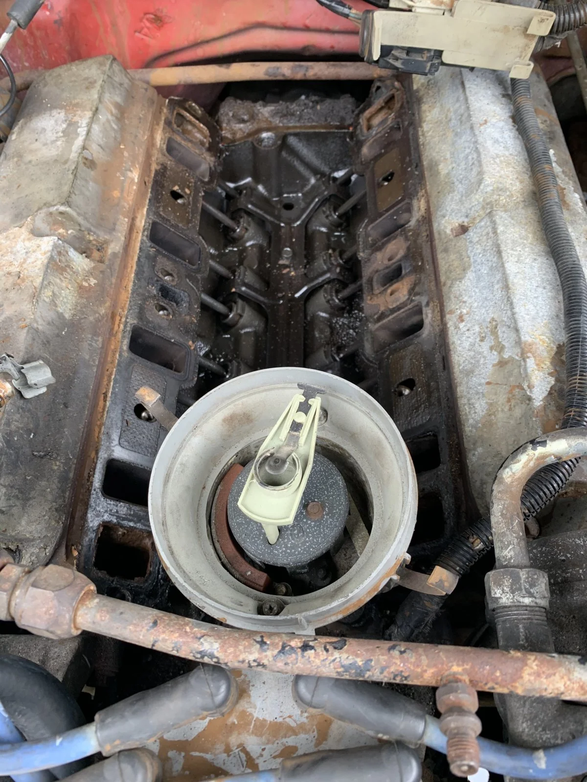

I’ve recently scored an upper and lower intake Manifold with the throttle body from an 96 explorer. I’m going to drill the holes in the lower and also convert the parts from the my stock tb to the new one once I have everything cleaned up ..my main question is do I have to change the stock maf or what are the proper adjusts I should make ?

Not sure if you know this, but the explorer throttle body will need to be modified to fit your car. There are several youtube videos on it and it's a fairly easy conversion
No. Bolt it on and go.
Thanks, this is my first upgrade to the original stock motor
Won't hurt to stay with stay with stock MAF, but if you can find a complete 94/95 MAF it would be a worthwhile upgrade. 75mm vs 55mm.
Oh and converting the TB is here
https://www.stangnet.com/mustang-fo...-an-explorer-65mm-tb-to-work-on-a-fox.901006/
Thanks . This would be my first time upgrading anything on my bone stock Fox . Wish me luck !!
