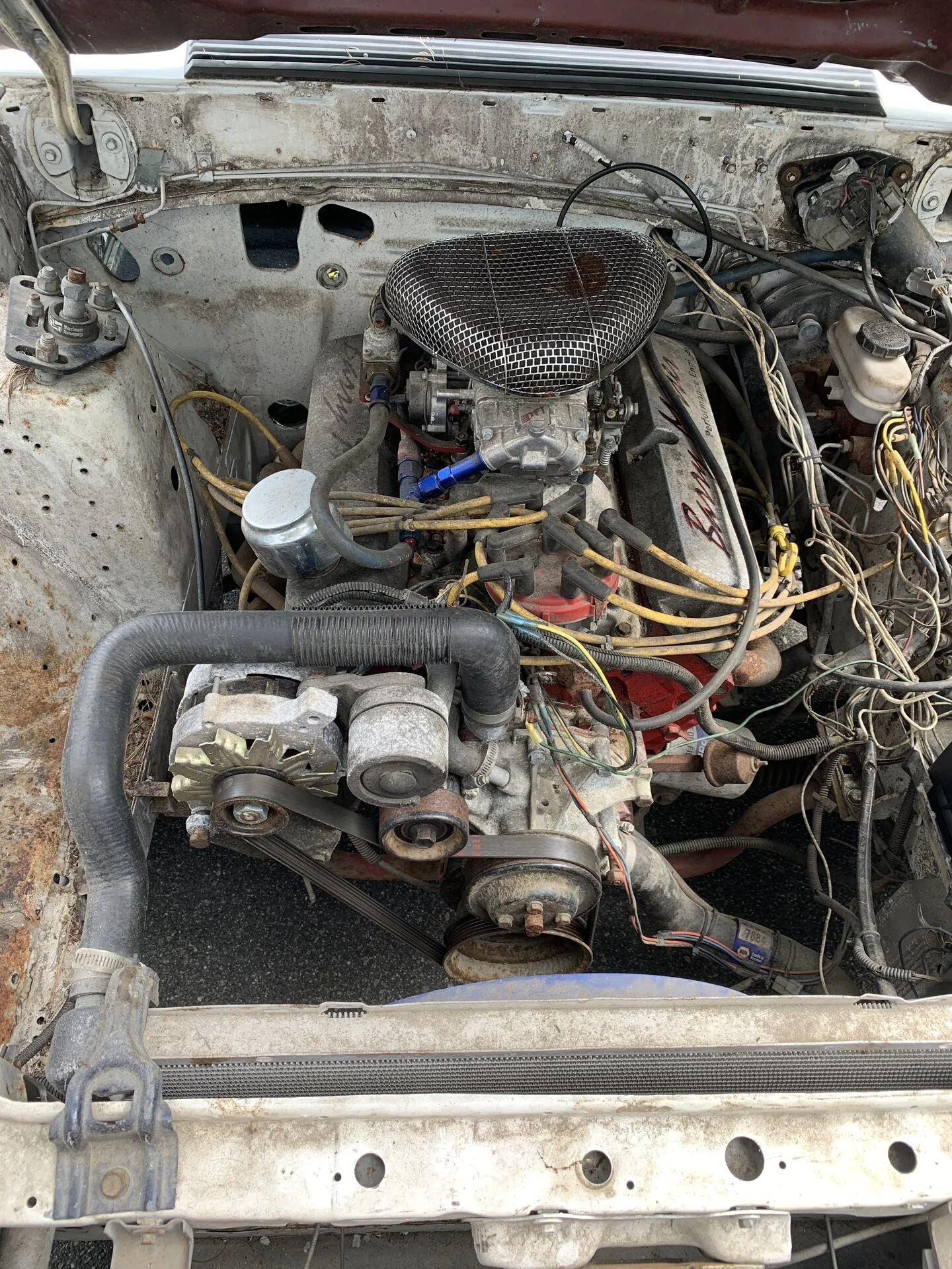

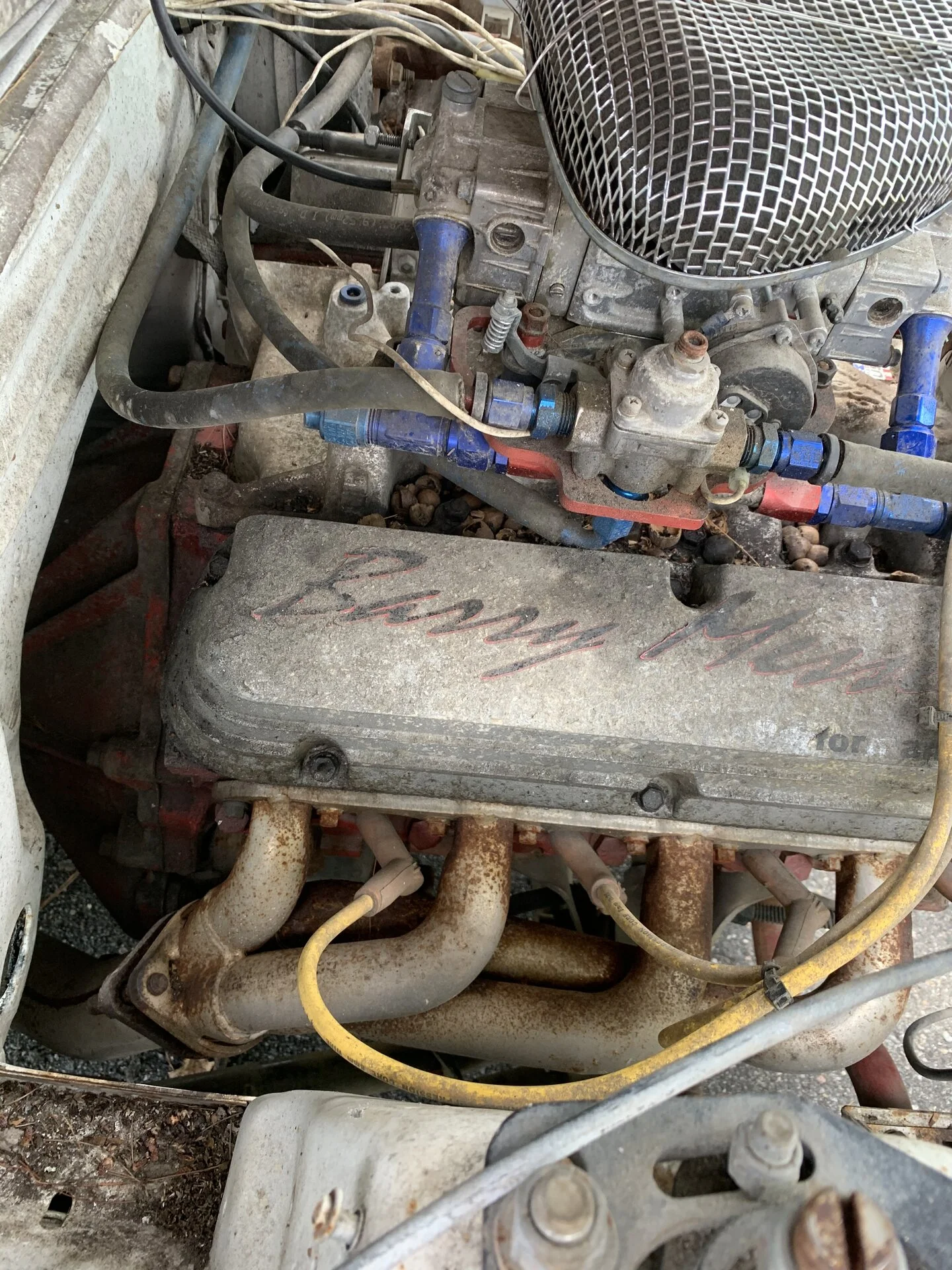

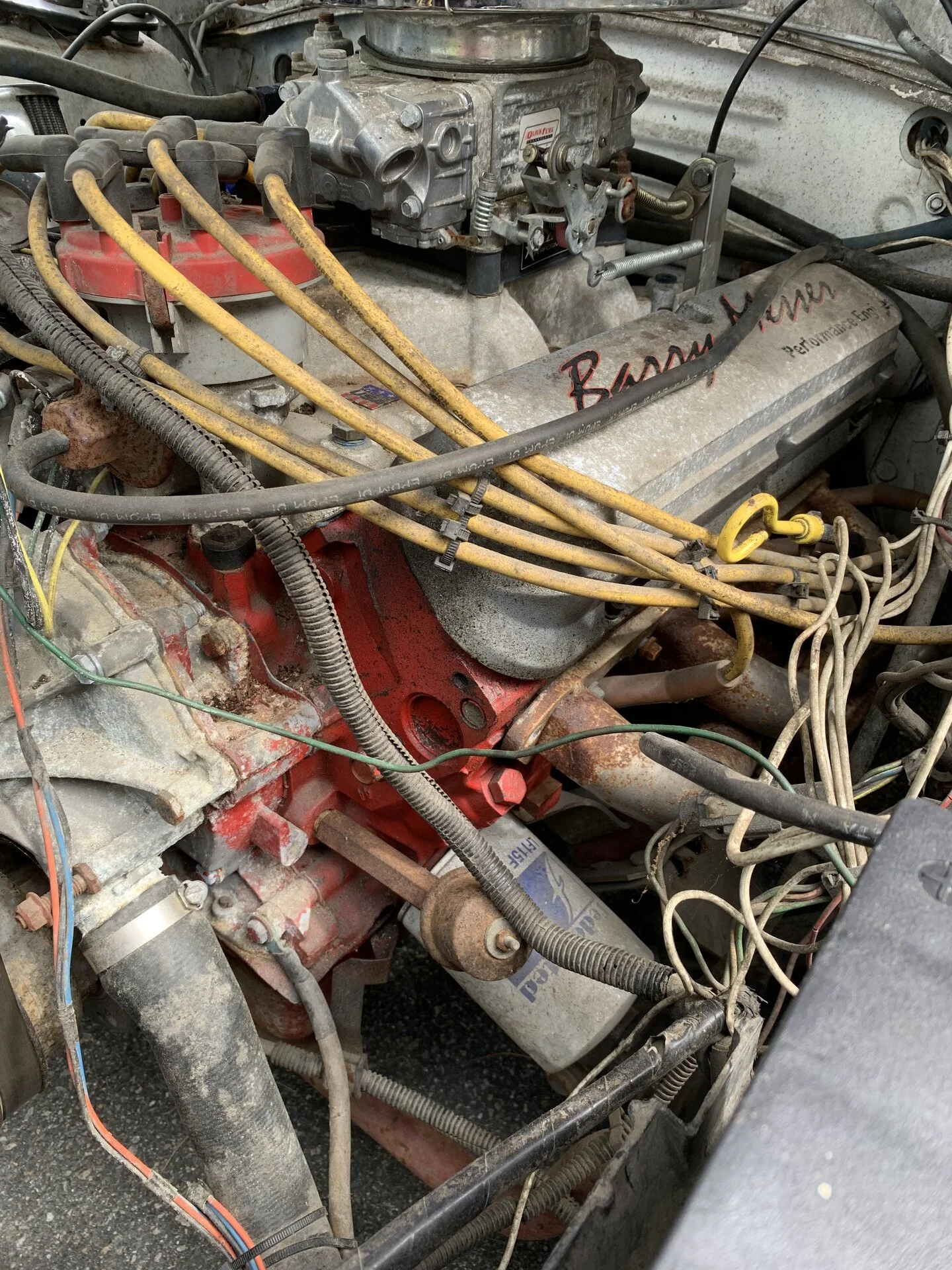

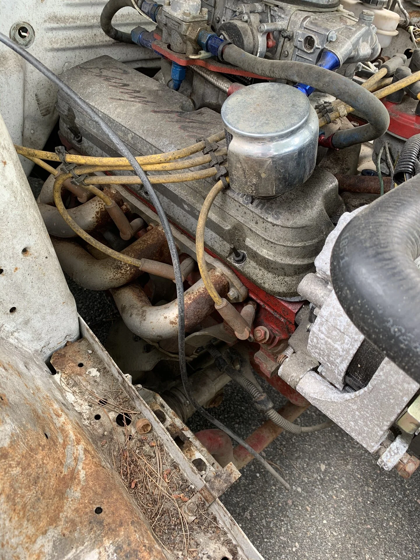

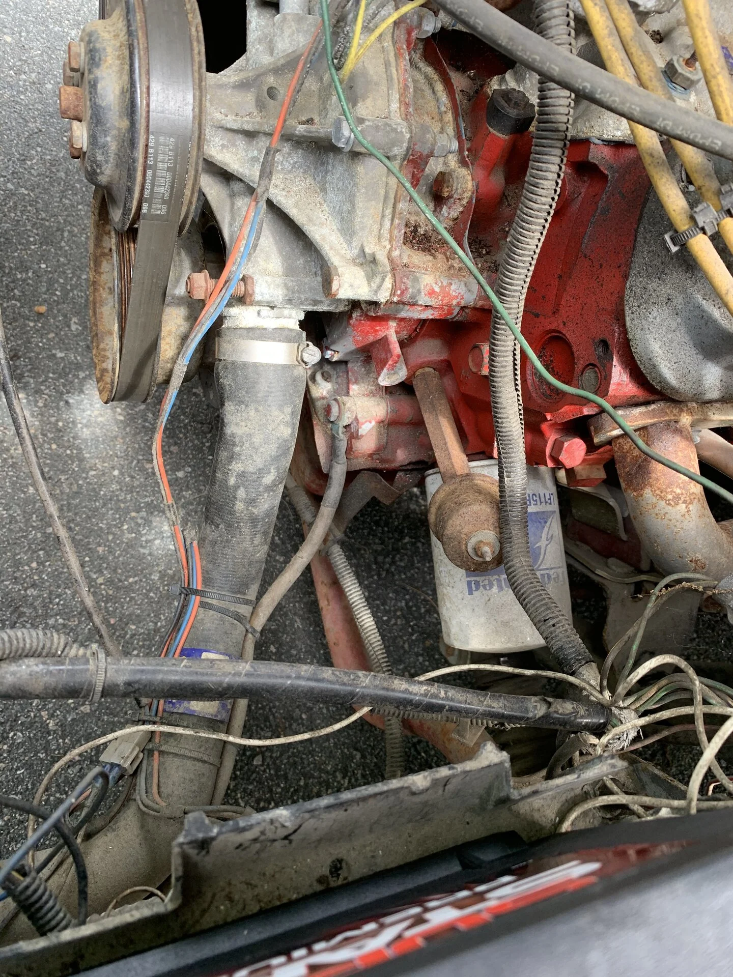

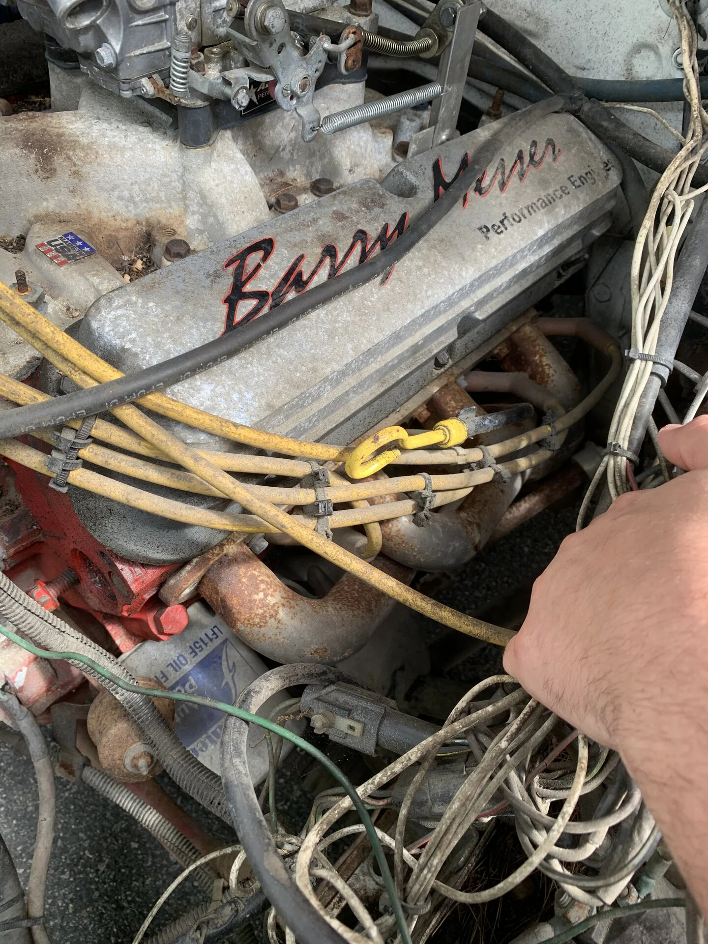

do any of these pics help? Don’t mind the spaghetti wiring, I’ll be taking care of that ASAP. I come from building motorcycles with custom harnesses, and this being 80% drag car it doesn’t need a whole lot of wiring

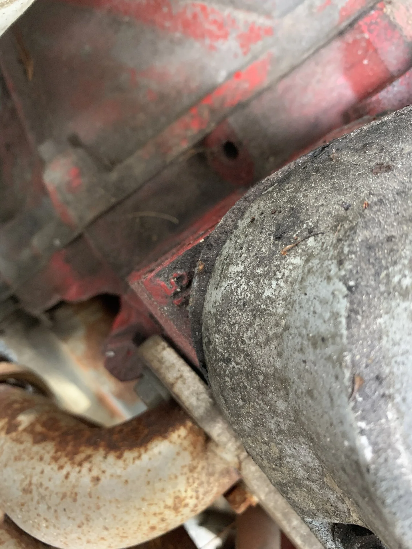

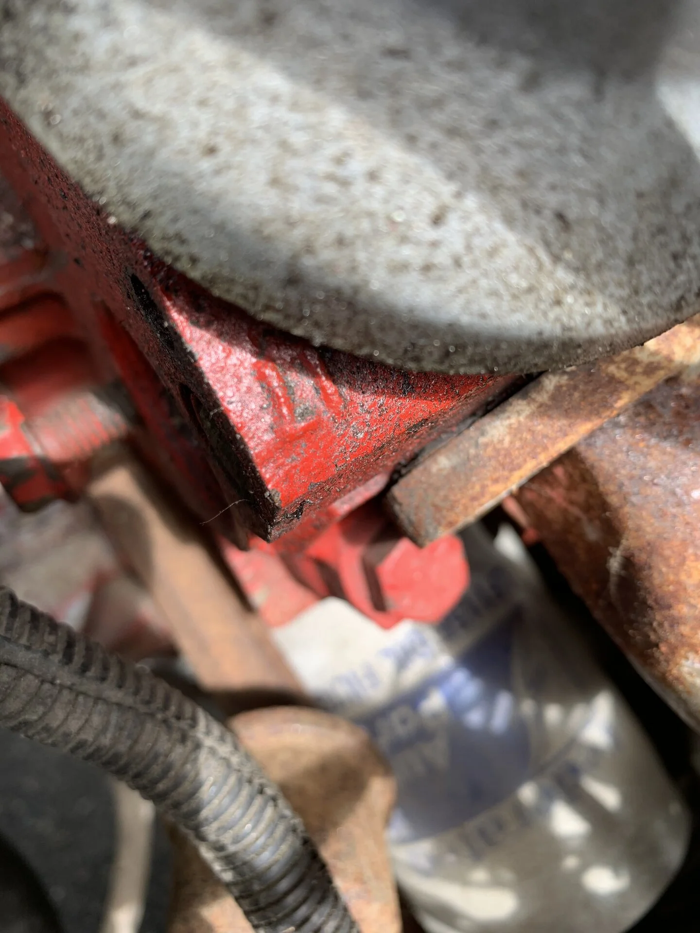

They are not GT40/40P heads. They actually look like E7's. I see a number on one corner of the head. In the opposite corner of the head, do you see a T? If so, they are E7 (stock 87+) heads.
If that's the case, you are probably in the 250 +/- 10HP Crank HP range.
This is all I could find for markings, 17 for drivers side 15 for passenger. Am I looking at the right corners here?
Yes, right location.
So heads are still unknown. Any desire to pop a valve cover and look for casting marks underneath? Don't go out of your way if that's a hassle to do.

Yes, the valve cover removal would give better insight as to what is under there. Stock springs? Aftermarket springs? Roller rockers? and any date codes cast into the heads to try and ID them.
