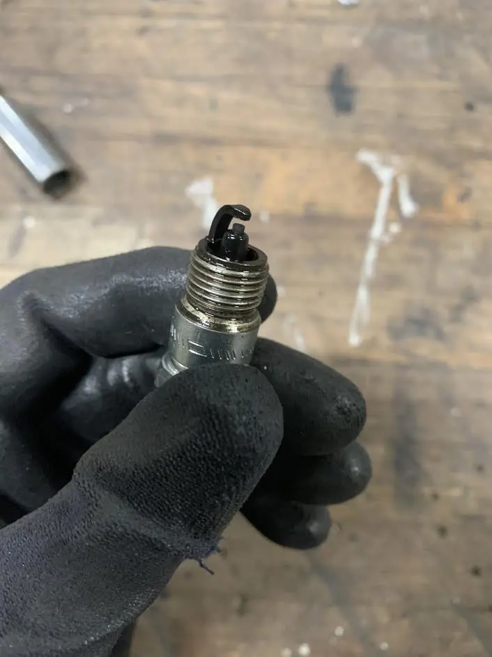

This is a picture of a plug on one of the bad cylinders. dark and wet. The plug is a champion 3018. Thanks
