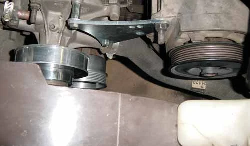

I am finally getting back to my A/C delete project. I am in need of some info on how to take of the belt tensioner, I need to relocate it between my power steering pump and water pump. I have tried and used a wrench but have had no luck. Is there a special way i need to do this or a special tool? Any help would be great.

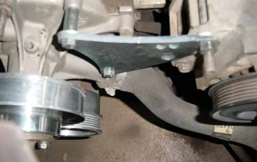

I am going to try and post a couple of pics..........the first one of is where the a/c delete plate is (between the water pump amd power steering) the seconfd one is a close up of the plate itself. You can see 3 holes in it. that is where the belt tensioner will be relocated.
Any ideas?
Thanks alot.

not sure if you got ur tensioner off yet but It was real easy, just one bolt in the middle of the part that holds the spring, not the bolt on the pulley. THen when you got to put it back on and u need to open it up just stick a breaker bar inbetween the two parts of the tensioner and just pull it up ... Thats what I did when I installed my FMS a/c delete kit, It worked good... I wasnt sure if there was a way to loosen the tension all together but this way is fine...
