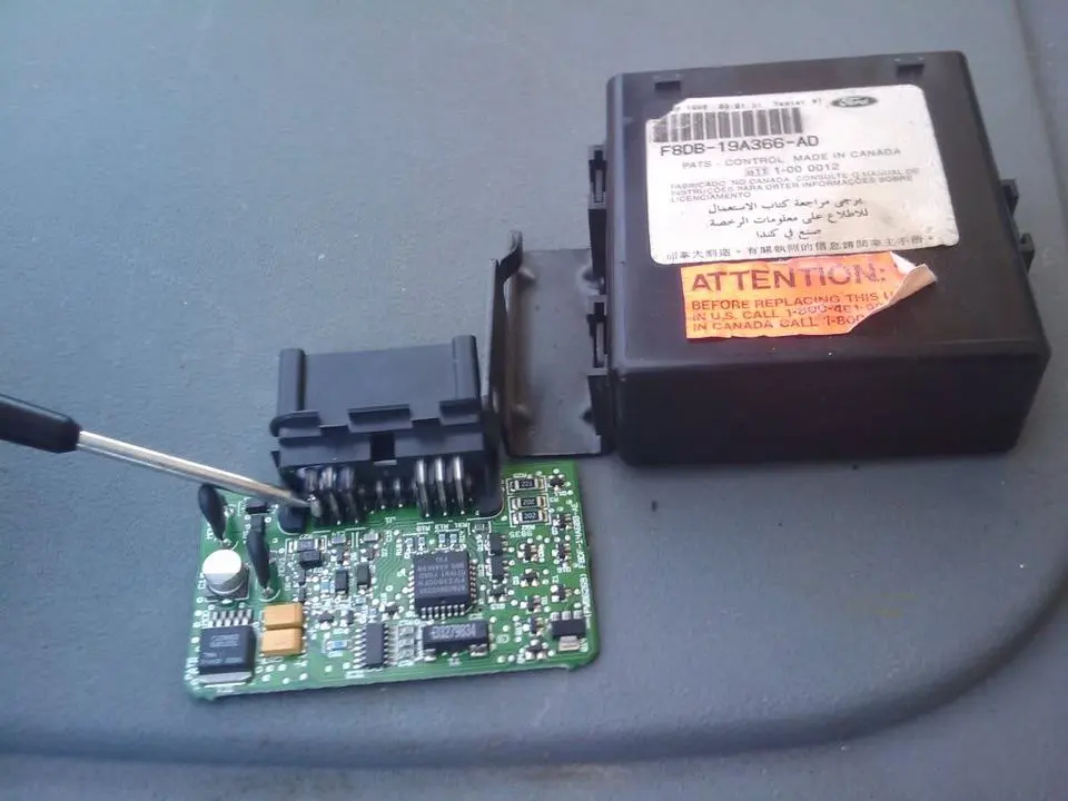

his email and pic
One of my buddies that knows his way around cars ended up coming over yesterday and i explained everything to him and he says''ok lets try to disarm the alarm to see if that will work''.He read online how to do it on a mustang and he wasnt getting a theft light then he said''something is wrong im not getting a theft light so i can disarm your system'', I then replaced the pats module and the theft light came on but i told him if i change that module i have to reprogram my key,he said ''thats fine''.The theft light came on and he said ''theres your problem,your module is fried because its not throwing a theft light to even reprogram the keys.Out of curiosity and not believing he figured out whats wrong with it within 2 hours i opened the module and one of the connectors was popped,it had a little gap inbetween a connector.He reconnected the module put a screwdriver inbetween the gap and i tried to start it an it fired right up then i looked at him in disbelieve
Im the happiest guy alive right now,you have been way way mre than helpfull i appreciate everything that you have helped me with thank you,If you are curious ill send you a pic of the part that was fried...........
