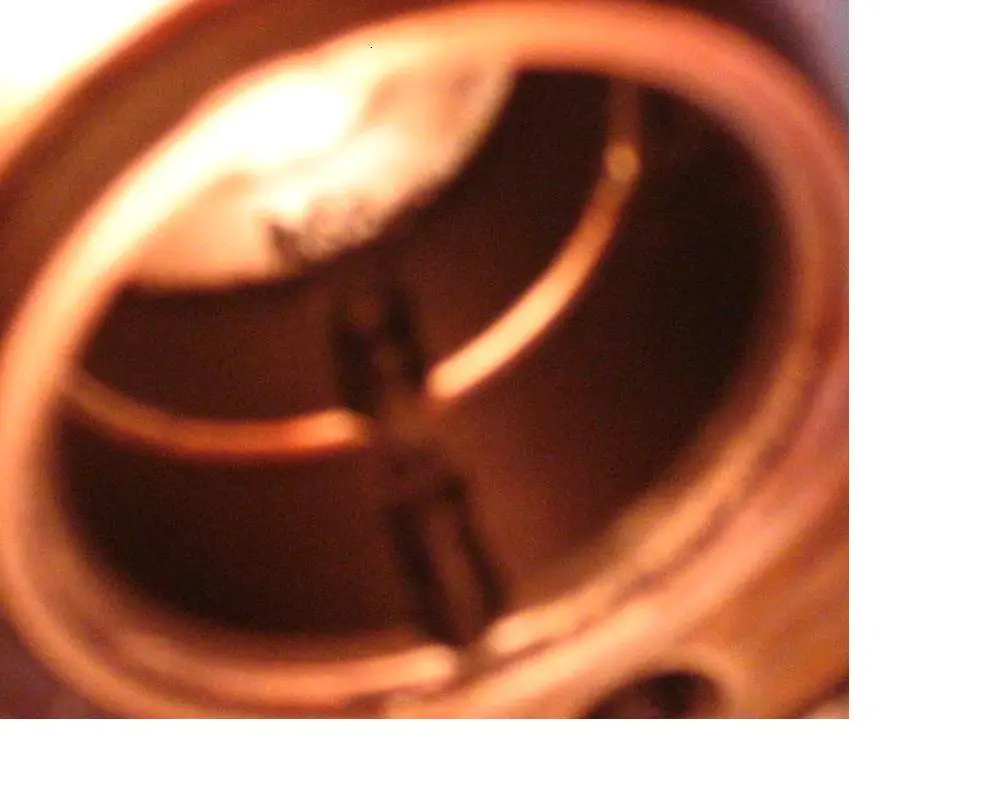

screwed.webp heres the groove sorry have a crappy cam
hummm that might actualy pose an issue was pilot bearing is a needle bearing that rides on that serface you screwed up. send PM to svttech76 as he would be the one able to tell you if thats gonna be an issue...
I think you're ok. Like cooper said, it's a pressed in bearing, and it won't create a leak or anything, I would just tap the new bearing in and see what happens. I have a feeling you will be ok. Just my 2 cents.
deburred the grove with some emery cloth and one of those foam sanding pads I pm'ed svttech76 and it was a life saver the piece that i acually put a groove in is actually a race that is pressed into the crank by ford thats why the groove was so large it was a softer medal than what the crank is sctually made of thanks all for the help
