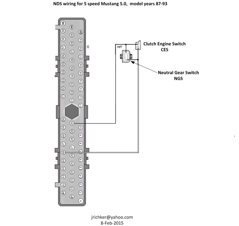

At this point in time, the simplest route may be to cut and cap the wire going to pin 46. Leave a 6" stub on the computer end to splice a new wire onto. Then run the new wire to the places it needs to go. That would be the clutch switch and the NSS sensor on the transmission.

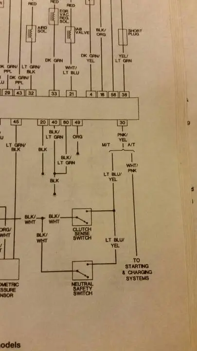

nds-wiring-for-5-speed-mustang-5-0-model-years-87-93-gif.529863
Ok, if I'm looking looking at this right, can I not just ground pins 30 and 46 together at at the computer (to body) since my NSS is jumped anyways? It would be kinda of a waste to run a new wire to a jumped NSS switch?
I just bought a Haynes manual, I'm going to try and unplug every sensor on these pins and see if I can't narrow it down. Hopfully I can find the "redneck" splice in this circuit.
Again thanks for the help, and I will report back with whatever I figure out.
Looking at this diagram, if you look at the pin 30, a/t side. The white/pink wire, it goes to starting/charging systems. But the m/t it doesn't. That would definitely feed 12 volts back. I wonder if that is my problem wire? If I was to find that wire and cut it, wonder if that would be it?
The problem with the diagram is that it doesn't show you all the wire and the loop that the O2 sensor harness makes to use the same body harness work fro auto trans and 5 Speed. The same thing can be said for the diagram I posted. There are some wiring and connections not shown for the auto trans for simplicity's sake..
Yea I see that now, that white pink wire is the one that's jumped at the NSS, and with my tranny harness not hooked up, and it still having voltage don't make since it's that wire. So maybe if I disconnect every sensor one at a time that's on this circuit I may narrow down the problem. I shall try that and hopefully something shows up.
This is typically how 12v gets sent to pin 46 to begin with. In an Auto setup, the ground to pin 30 is sourced from the starter solenoid control wire. The red/blue one. I know it sounds confusing, and it is. But that is how Ford did it. They use the relay coil to get the ground when there is no 12v flowing through it, as that will read as a ground when not starting the engine. So if you ground pin 30, you will have a short when starting. Im starting to agree with JR, and I am thinking the previous owner did something fishy.

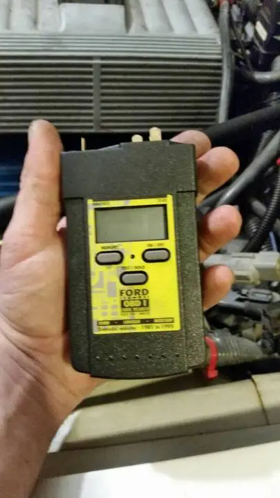

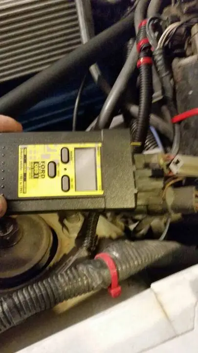

Ok, I have a weird development, I was just out there until hooking every plug I could see. Nothing was making voltage go away. Then I noticed I had the code reader I just bought still hooked up, so I unhooked it. Now I only have .3 DC volts at pin 46. Lol. I hook it up and get 12 volts. So this nice code reader may have been my thorn the whole time? Does this make sense?
So my question is .3 volts ok? And do I have a default reader that has been my prob this whole time? :/

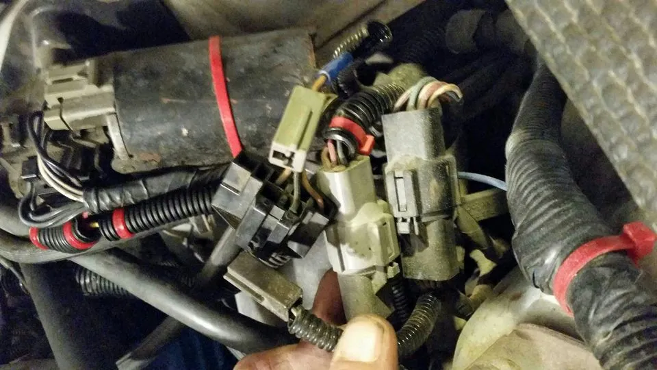

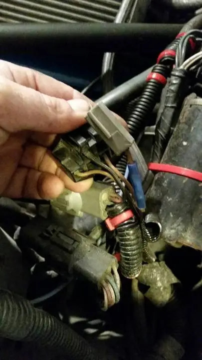

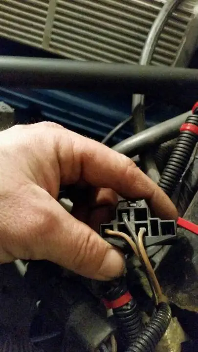

The small plug with the blue butt connector on it. Does that show 12v?
No I can leave that unhooked and still have 12 volts with that scanner hooked up. But when I unhook that scanner with the bigger plug it goes away. I just started it, no more check engine light. Not sure what's going in but it's either that scanner or the main plug for scanner.
Not sure the scanner is the issue. Some people have used the hood light connector by accident. That's why I asked if that plug had 12v on it. Scanner is battery powered correct? Nothing in the code test port should have 12v technically. The fuel pump ground may show it, when no ground is applied to the relay. The STO is a pulsed ground from the ECM, its tied into the check engine light. Which has 12v on the opposite side of it. STI is a 5v circuit, and SIGRTN(pin 46) is a ground. What are the voltages to the wires in the code test port?
I can see how the hood light would happen. Looks just like the other
