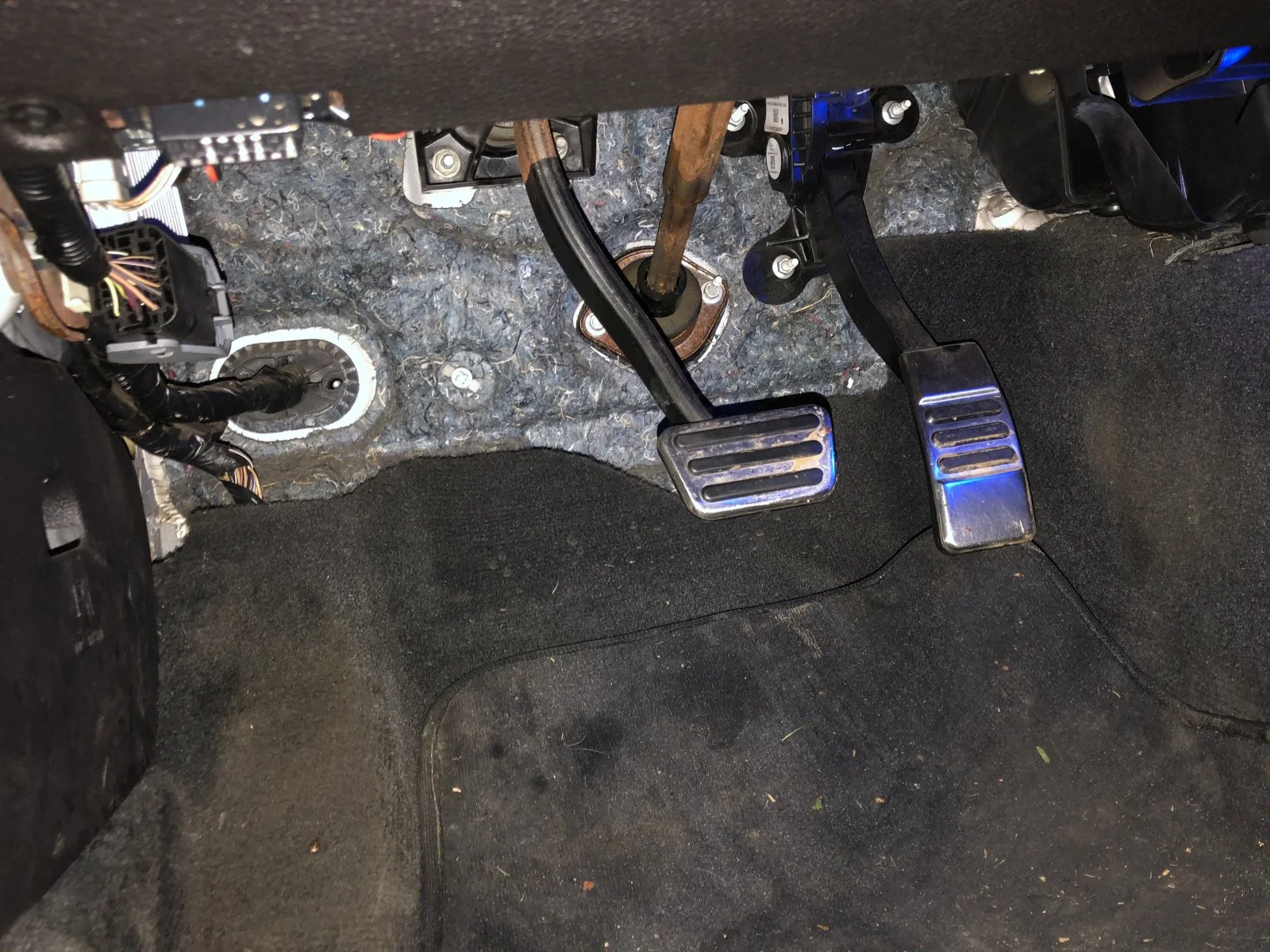

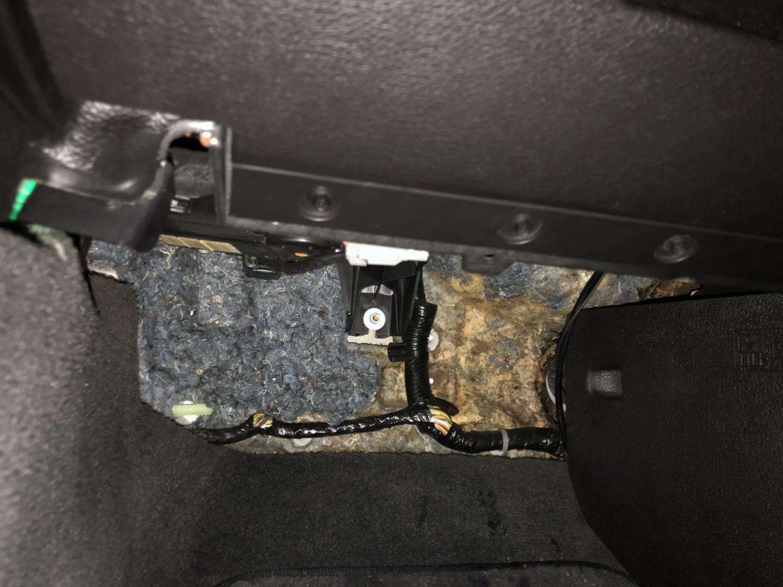

Ok so I recently just bought a 2011 mustangV6 premium. It has 140,000 miles on , it I got it for 6,000 so of course I assume something must be wrong or missing on it. It recently just rained pretty hard here in Tennessee and I went to go move my car and noticed drops of water coming down on my feet then when I go to look under I see this. I’m sure I’m pry asking a dumb question but is is supposed to look like this underneath? I’m really new to all this so any help would be nice.

You need to start with where is the water dripping from. Under the dash doesn't help. It could be a bad firewall seal, bad windshield seal and running down, could even be a plugged A/C drain (if you were running that).
Need to find the drip and go from there.

Yea I figured that. When I bought the car the ac wasn’t working I saw it was missing the cap and I’m sure it’s pry missing more than that I’m going to go get it checked out tomorrow. Thank you for the help
