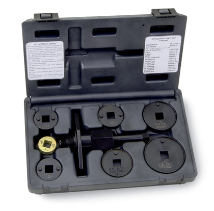

The rear brake caliper piston screws/twists in!!! You can not push it back in like the fronts. Go rent a tool from AZ for that.
blackfang: yeah you got it right on the money
for some reason the rear caliper piston will only rotate in... i believe something to do with the parking brake doing self adjusting stuff :shrug: my haynes manual didnt help any if at all on the subj. either way i found three ways to do this only one way to do it right. first you can use a pair of needle nose pliers and move the piston around 1/4 turn per knuckle scratch and 4 letter word, you can use the $12 "universal" cube from napa that wont fit this app whatsoever, OR you can rent that tool, rear caliper compressor, from AZ. the tool saved me about 2 hours by needle nose pliers and saved the piston from certain scoring.
