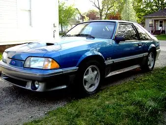

Just picked up a '88 gt - Ate the last battery and I wasn't sure if that battery was new or not so I Threw a new battery in her and she ate this one too.
Starter=New - Battery=New - Alternator=New - Relay tested and correct
Where do I go from here? it was semi intermittent for about a week, but today she just died and wouldn't start even with a jump? Acts like a normal dead battery like when the lights are left on - trys to roll over but just not enough oomph to crank the motor.
Any Ideas what to check next? Coil Maybe?
