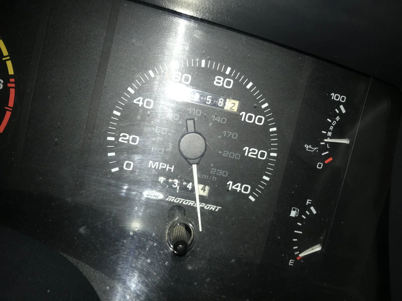

My spedometer in my 1991 gt bounces around, it smoothes out a little over 30 mph, but I just replaced the spedo cable and the drive gear and it's still doing the same thing. I looked at the driven gear and it seems fine too, anybody know what else it could be?
