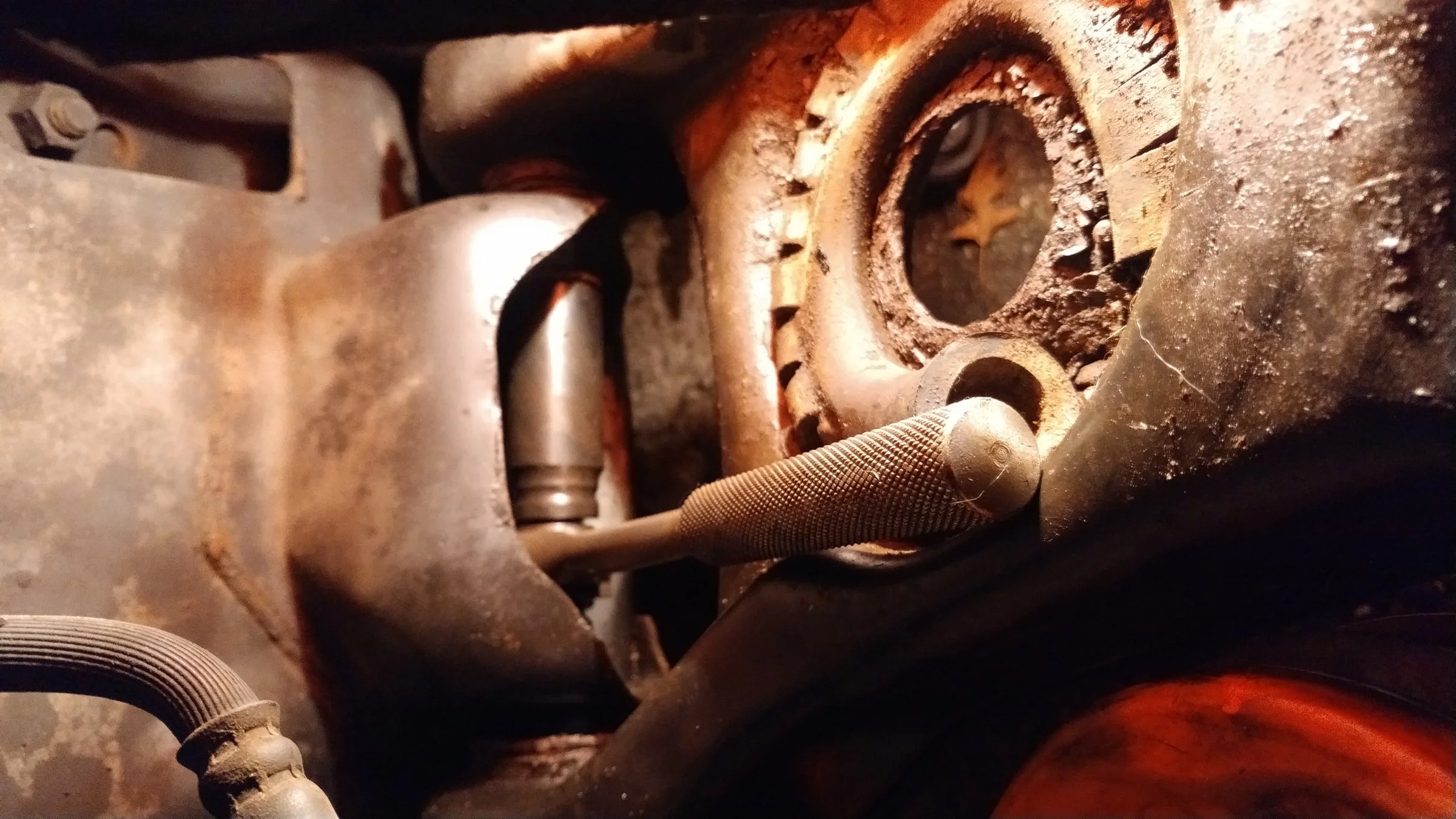

I was taking off my control arm and got my ratchet stuck between the two nuts on the inside. Probably shouldn't have used a deepwell socket lol. Any advice on how to get ratchet out? I tried just changing the gears but the stud is right up against the ratchet head, can't move it at all.
Use a pick or screwdriver to switch directions on the ratchet, tighten the nut until you can get the ratchet and socket off, and then get back after it with a wrench.
All other options will involve some sort of destruction.
