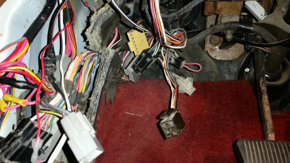

Hi all,
so i just did my heater core in my 89gt.. wasnt as bad as i was expecting, but its done, so im happy. In doing this i pulled the dash and unplugged tons of stuff... i think i plugged it all back in but i have a bunch of stuff under the driver side that doesnt apprear to hook up to anything... are these all inspection ports or did i miss some stuff.. everything appears to be working fine to me... should these be plugged into anything?
i do have a couple clipped wires from when someone had a remote start in it at one point, and when people re ran speaker wires. but i think the wiring is fairly back to stock now.
unplugged stuff:
1. at the dside kick panel there is a 4 plug male with nothing to plug into.
2. attached to the gas pedal bracket there are two small plugs, believe they are two port each...
3. there are two one port plugs female, believe they are black and yellow thick gauge coming off the main wiring harness to the left of the coulmn.
4. there are two other large plugs coming off the main harness, one is 6 wire, one is 8 or 9.. one grey, think the other is black....
5. there are two ports, one clear one black similar shaped... believe these are both for manual cars/ clutch related..
does it make sense these all being unplugged? all diagnostic?

Pic
Missing from that photo is the 2 female single wire black wire plugs, at bottom of column.. The connector for one is hanging just on the top of the pic.
The black amd clear plugs on the top right are stick shift plugs I think...
There s then the one hanging down and the three clustered to the left and the one in. The foreground.

ok so the unplugged connectors are the following:
2 convt plugs, clutch switch, - na to my car
anyone know if/what should be plugged into the following?
speed controll amplifier ??????
horn relay, anyone know the part number?
day/night illumination relay?????
A/C Blower motor resistor????? ac is removed on my car, and the blower works properly currently.
