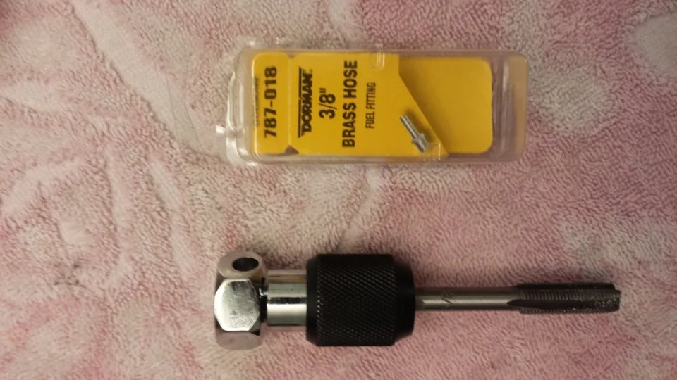

Can someone please help me figure this out? I've never used a tap before and I have need to tap an already existing hole in the intake. I went out and bought a tap set and a brass fitting to put in the hole. Attached is a picture of the fitting and the harbor freight tap. The fitting says 3/8" so I used the 3/8" tap. On one hole I used a tap that says 3/8"-16NC. The 3/8" brass fitting I have will NOT go in there. I was able to get a 1/8" fitting to fit and so I put that in with Teflon tape. On the other hole I am using a tap labeled 3/8" NF 24. It made the threads and looks good to my eye, but the fitting still will not screw in to it. Can anyone tell me what tap I need to use in order to get this stupid fitting to thread in? Thanks for any help....

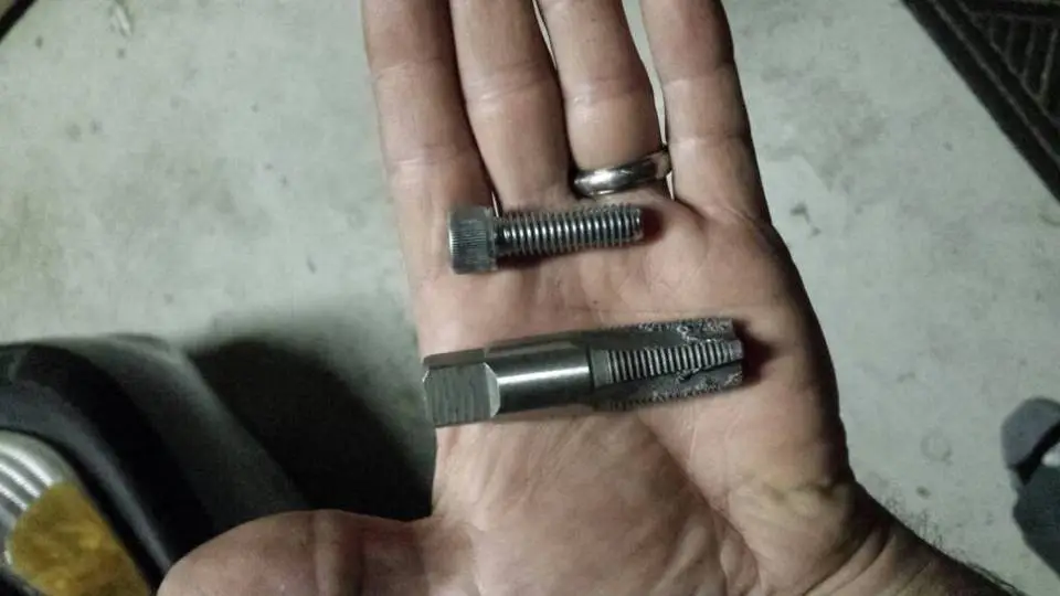

Pipe fittings are measured by the inner diameter of the pipe. Bolts are measured by the outer diameter. That's why two different 3/8 taps look so different. Lol, someone had to explain this to me several years ago.

Per the Dorman site the 787-018 brass fitting is for 3/8" hose, but the threaded end is 1/8"MNPT
I didn't look that far into it. Just saw 3/8 and ran with it.
Thanks for the. Correction.

And National Pipe Thread is tapered so the more you twist it together, the tighter and leak resistant it fits. Bolt teeth are the same size for the length of the bolt. (Or at least the length of the threaded part.) So if you get one of each with the same threads per inch, it will not really fit right and seal or torque correctly.

Thanks for everyone's help.... the trick was knowing the threaded part was 1/8 NPT. I didn't even think of looking on their website to see the specs, so thanks Saleen0679... I had a 1/8 NPT included in the Harbor Freight kit I bought and that worked great. Screwed right in with no problems after that. And to add to the list of stuff I don't buy at Harbor Freight... power tools that I expect to use more than once. I will not buy a drill or saw from them. If I only ever plan on using it once I might go for it, but I've had too many crap out on me in the middle of something for me to rely on them at all..... thanks again everyone....
